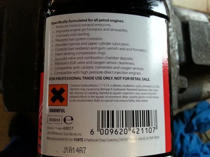

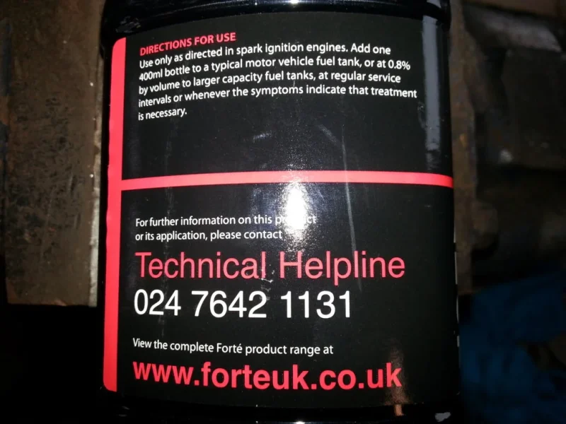

Tony - does this work on all types of cat? I have a CO emissions problem (.5%) which hardly changes on fast idle and had convinced myself cat is knackered. I was going to try a cleaner but there was a comment in a thread the other day (can't find it at the moment) that cleaner only works on certain types of cat convertor.
So how often do you put this stuff in your tank? Or is it best only to do it prior the MOT so it has a better chance of passing?
Hope this helps chaps, if you need more info, and I can get it for you let me know.
I think it might be a good idea for Gaz to give this a try even though it is no specifically for oil consumption. I had a Volvo using about as much oil as Gaz and decided to try an additive much like this. As I drove I could see my tach readings going up as things freed up and after two treatments found oil consumption was negligible. JIM
