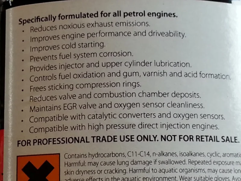

Tony - does this work on all types of cat? I have a CO emissions problem (.5%) which hardly changes on fast idle and had convinced myself cat is knackered. I was going to try a cleaner but there was a comment in a thread the other day (can't find it at the moment) that cleaner only works on certain types of cat convertor.

We use it in all types of petrol cars, and mainly with very good results. If a cat is simply "dirty" it will clean it. Their diesel products are very good too. I have a bottle in my garage, I will try to photograph the label and see if I can post it for you tomorrow night?

So how often do you put this stuff in your tank? Or is it best only to do it prior the MOT so it has a better chance of passing?
Well the FORTE rep. unsurprisingly suggests you use it fairly regularly (after all he is selling the product). I use it in mine twice a year, once soon after the car is back on the road if it has been stood over winter months and again later in the year. Also it needs to be at a low fuel level so as not to dilute it too much. We sell it at work for £12 + vat = £15.
