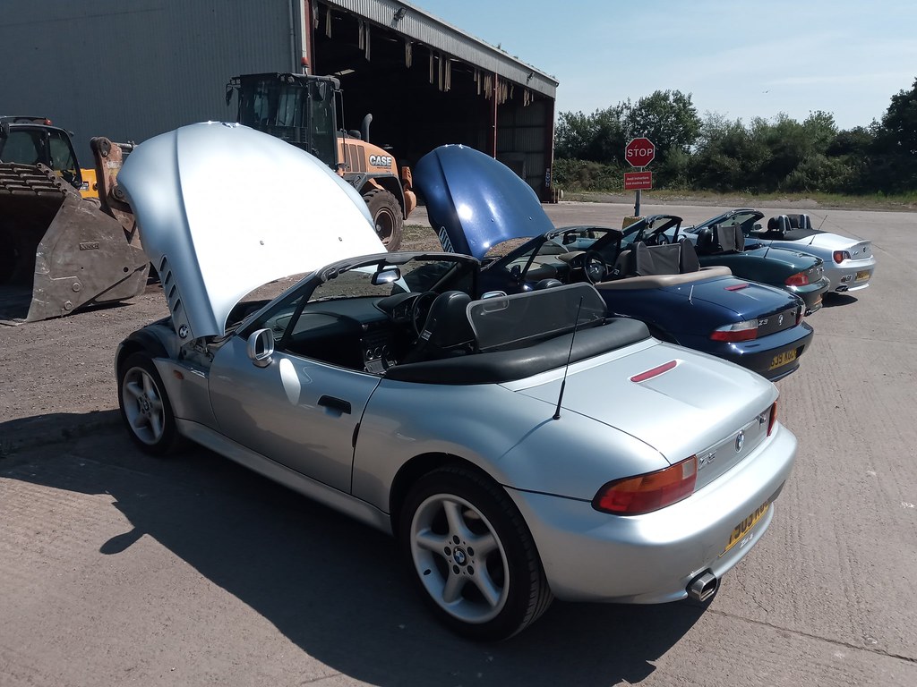

A few of us made our way to Lydney. Gloucestershire and met up socially distanced at Nodzeds Zedshed, participants from Newport, Blaina, Worcester and 2 x Bristol, all but one in Z3's the odd one out being a Z4. Usual chat and the laptop was brought out and the now Non Crusty Dave's 2.2 was scanned as it had the MIL lit up. Codes for exhaust sensors found but cleared, didn't come back and further checked with Engine Check Pro software to see what live data they were giving out, all appeared to be performing ok, maybe Bank 2 bit slower than Bank 1. Given the 93k mileage Dave will be looking at replacing all of them in the meantime we await to see if the MIL returns. ABS has at least one fault showing pressure sensor, need to investigate that further.
Laptop onto Nodzeds car and only a few historical codes, nothing serious and all explainable from battery being disconnected in the past, all cleared and not returned. Interestingly this car would only communicate with INPA it wouldn't connect using BMW Scanner 1.4 like we did with Daves, I suspect its OBD1 and not OBD2 which Scanner 1.4 works on.
