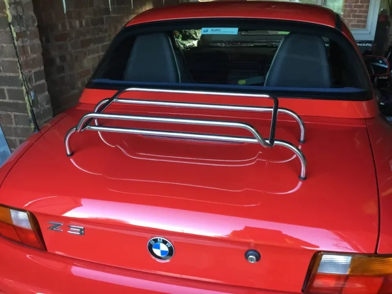

Easiest way is to look for a bootlid for sale that has the fitting kit installed - the one I've shown is one I bought off a forum member who changed it for a non molested boot lid. They do come up and usually cheap. When rack not fitted there are plugs that resemble coach bolts that go in - they are harder to get. I was lucky in buying a brand new rack with full fitting kit that is on the car shown. I got the spare boot lid with fittings for my pre facelift zed.

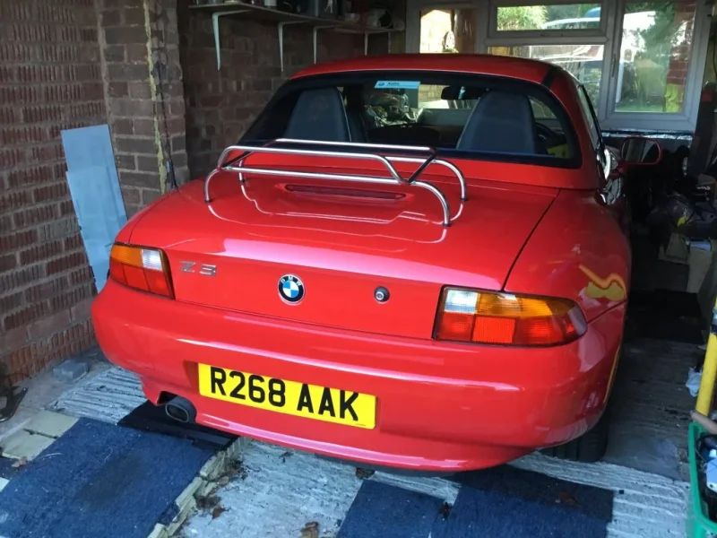

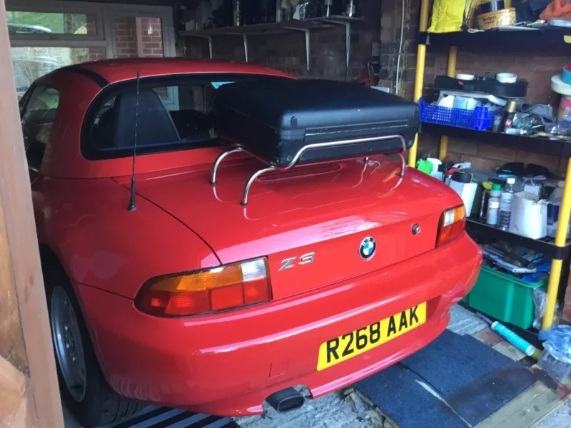

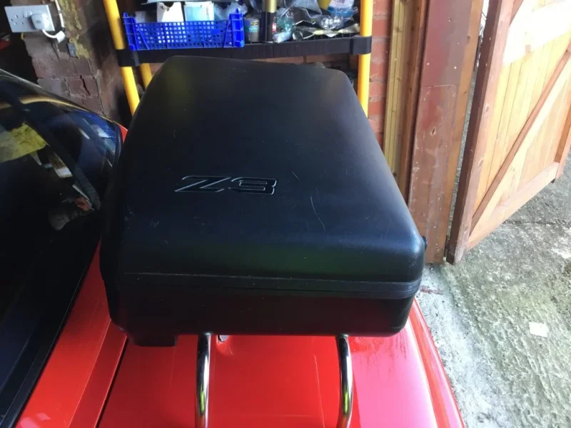

thanks for all of the help and advice, I managed to get some spacers, washers and neoprene washers from Screwfix and have now managed to install the rack.
went out in the rain yesterday and I can confirm it is waterproof
photos attached
