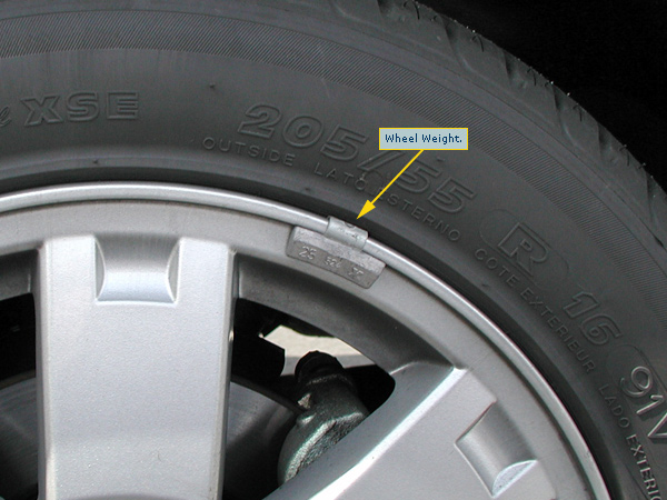

The wheel weights don't clear the caliper!
I tried moving them inward a little, but still no good, so we're stuffed.
For now, i've popped the 1er's 18's back on and there's loads of clearance. You'd think about 0.5 inch... right?
Nope, nearly a full inch. The problem seems to be the design of the Style 18's just restricts the clearance space.

4) Had this idea... Remove the tyres, and move the weights to the inside? This that a done thing?
5) Fit a wheel spacer. The Wheel is tapered so the further out it sits, the more clearance it'll have. Will trial fit a 3mm spacer tomorrow and see if that might work..
6) Haven't thought of a sixth option.... any ideas?

You can get the wheels balanced on the inner or the outer edge i think. They set the machine up for the different placement would be worth asking but sure it can be done.:thumbsup:
I think you have to have a lip on the rim for that to work, which the Z3 rims don't have. Something like this....
Can't move the weights any further out without placing them on the visible face, which would look pretty horid.

You can set the machine and using stick on weight fit it on the inner edge or just behind the spokes.
You can balance behind the spokes.

Can be set to balance like so can you get it cleared with weight on inside edge?

I think you guys are vastly underestimating the clearance issue here. There is about 1.5mm between rim and caliper, there is about 1mm of clearance between caliper and spoke.
Unless the weights go over the edge on the visible part, i'm not sure how to make this combination work...
Looks a bit daft, or am I being too critical?
Does the gap improve when you fit the anti-rattle spring Aaron, the calliper isn't pulled completely back to the carrier without it fitted. It may not be quite as bad as it looks?

That really is mega tight im sure you can space the fronts on the stock set up but not sure even that would give you clearance :(
I don't think it's as bad as it looks Ant, without the spring on and not even had the calliper pumped out (which will pull it away from the wheel) it can't be anywhere near it's final operating position. I think Aaron needs to finish the brakes before making any decisions.:)
You're right. That would help things a little. I didn't want to fit the springs yet as the paint was still soft, but i'll get the rear's on (since I know they're staying) and then get the front left bled and fitted properly before giving up.

As Jim would say, "And then the fight started" ;)=))=)) I think there'll be more room when you get the callipers pumped out too Aaron. Like the colour mate.

Ok, Tony, I owe you a pint, or rather the guy down the road trying to sell his 1er rims on ebay wants £600 off you, since I don't need to buy his wheels any more.
I carefully stuck the clips on and bingo, about 2mm of extra clearance and a rotating wheel with a very carefully positioned wheel weight.
Thanks Tony :thumbsup:
Tbh, I feel stupid now as it's sorta obvious now, but I guess the disappointment of my dad standing looking in amazement at the big brakes, closely followed by "err, those wheels don't rotate" kinda threw me off.
