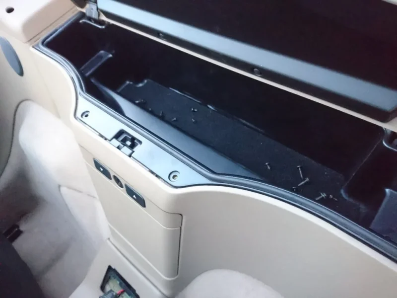

More of these things...grrr
Undo the lid...
And pull it away...
Lift this out...
Stare at this....
Now for the side bits (although again, I maybe didn't need to do this bit..)
You can just see those two lower screws...
You need three hands here, but you need to spread the sides of the rear console and pull it up an inch or so...
At the same time, pull the center box out ....

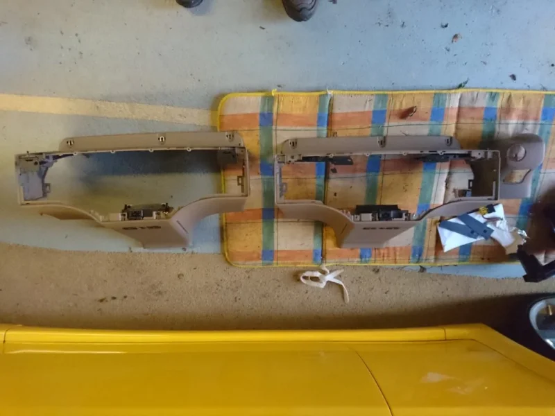

Now with the old and new center box on the floor beside each other, I've just realised they're exactly the same! The only difference is the lid bracket which is easily swapped over...
I had intended to swap the front storage box over (so that my key would still work) but it would probably make more sense if you were doing this mod in the future not to waste your time removing the box...
Anyway, next step is to remove the turret covers, although again, I now wonder if that's really necessary. You'll see later that you need need access to the Hoop securing screws, but two well drilled holes would give you all the access you need.... Anyway, I have the proper parts so we continue...
Screws out...
Undo the seatbelt from the seat and thread it back through.... and it's out...
See, side by side, that access panel (left) and the alternative wind deflector (right) is the only difference. If you don't have the right part a few holes in your current parts would do rightly...
