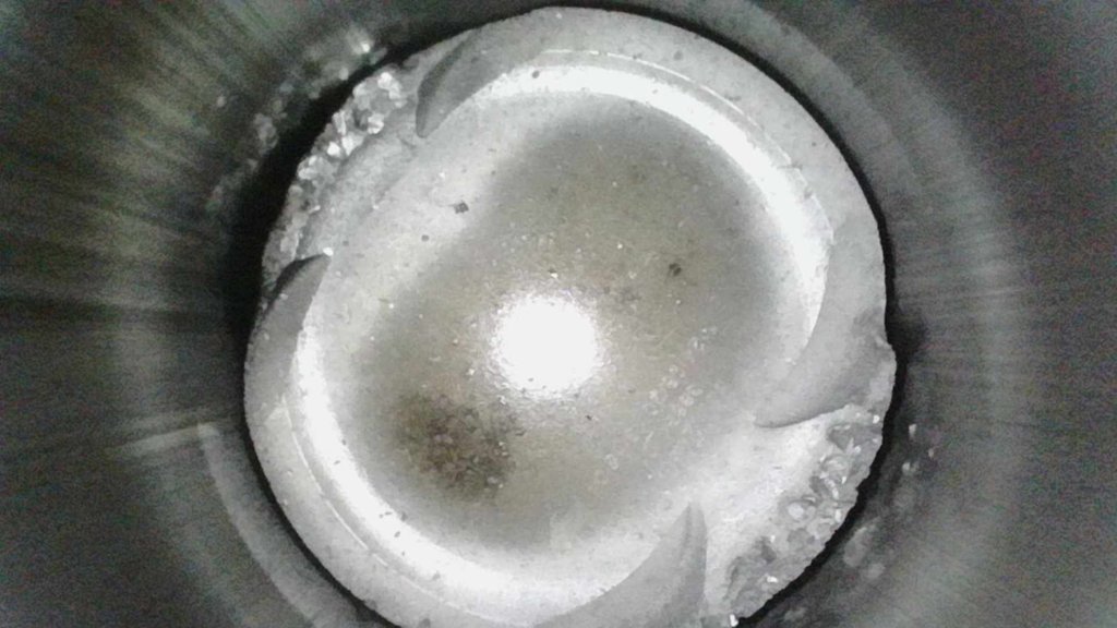

Said f it, came inside, was warm so opened the shade & saw...
Got as many pictures as I could from inside, went out & got a few before they said adios!
Pretty amazing how fast they can go from in a pool to gone.

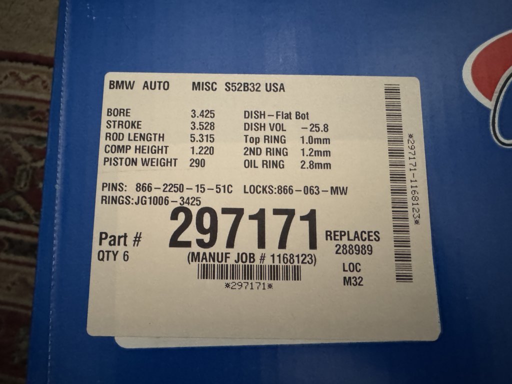

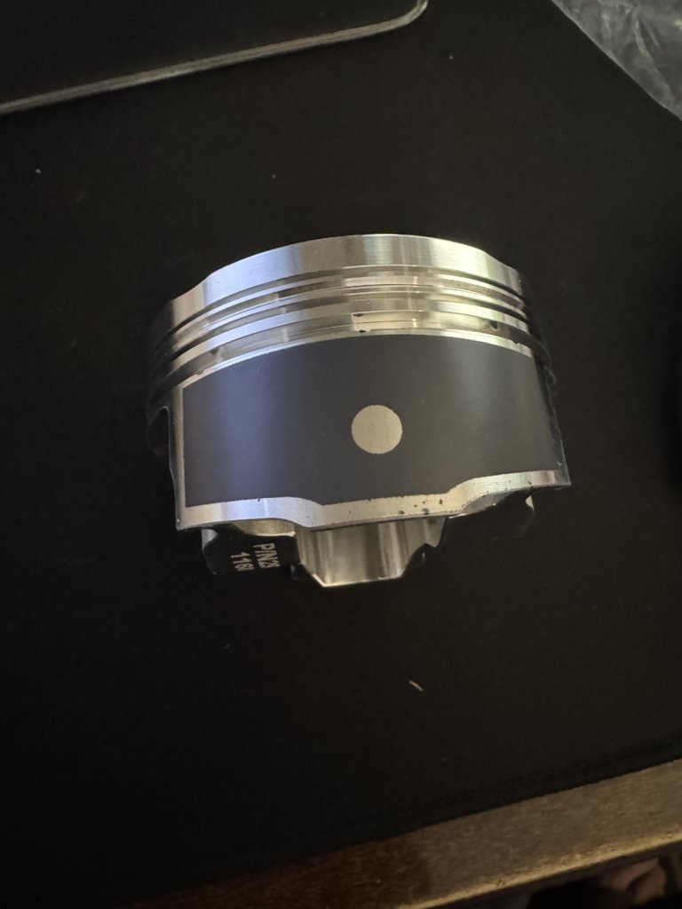

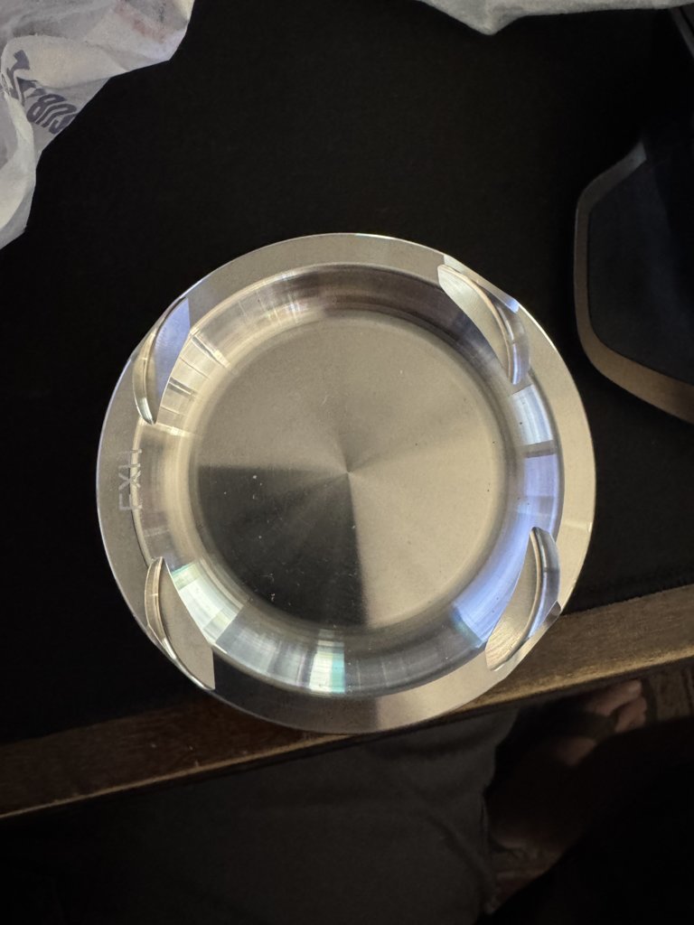

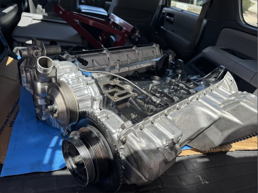

Had another unsuccessful experience with an MS41 tuner, the person who built my motor got me a deal on a Megasquirt based standalone & tune for it. It will be here tomorrow & I'll install it.
It is similar to this but for S52.
