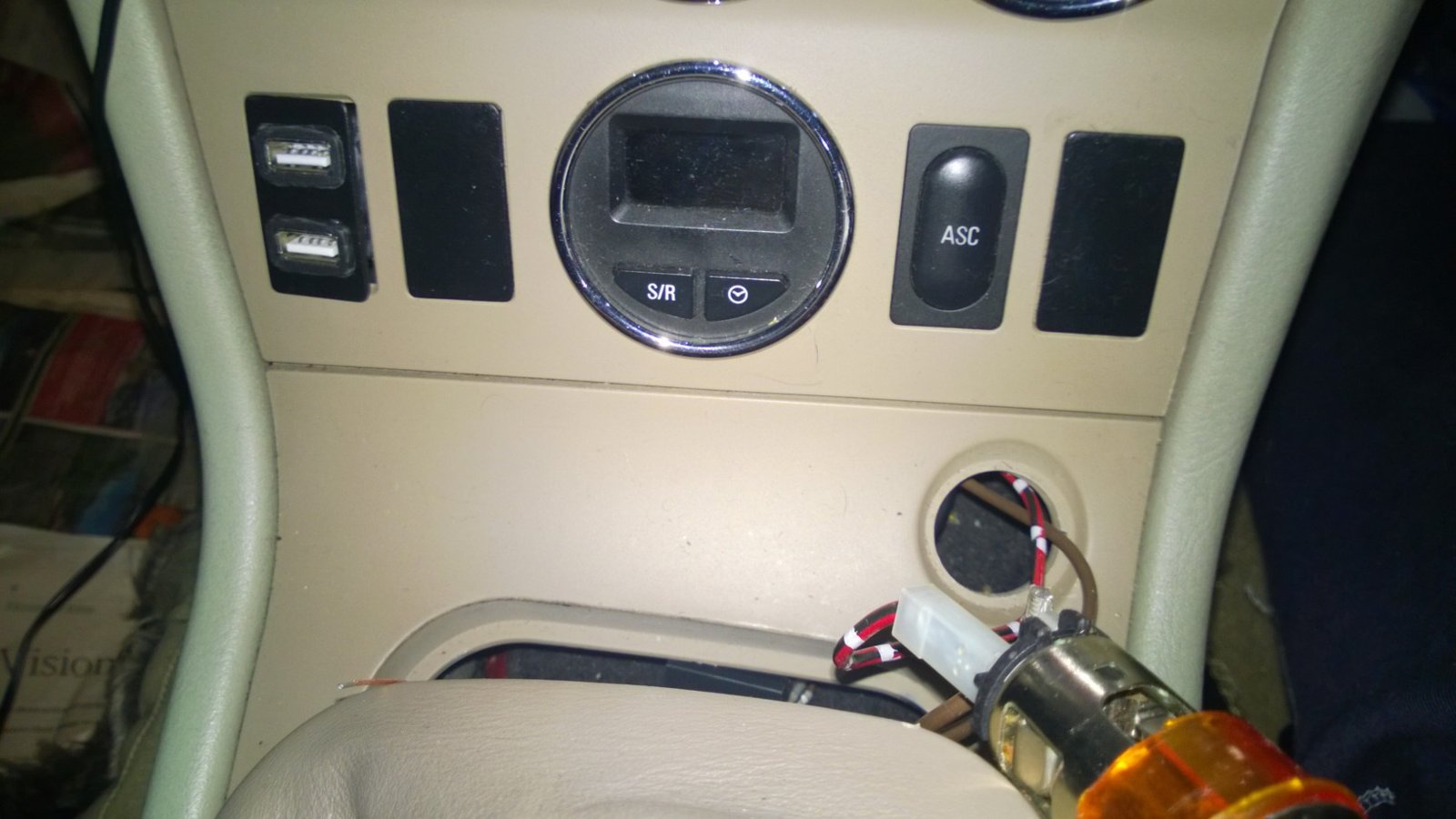

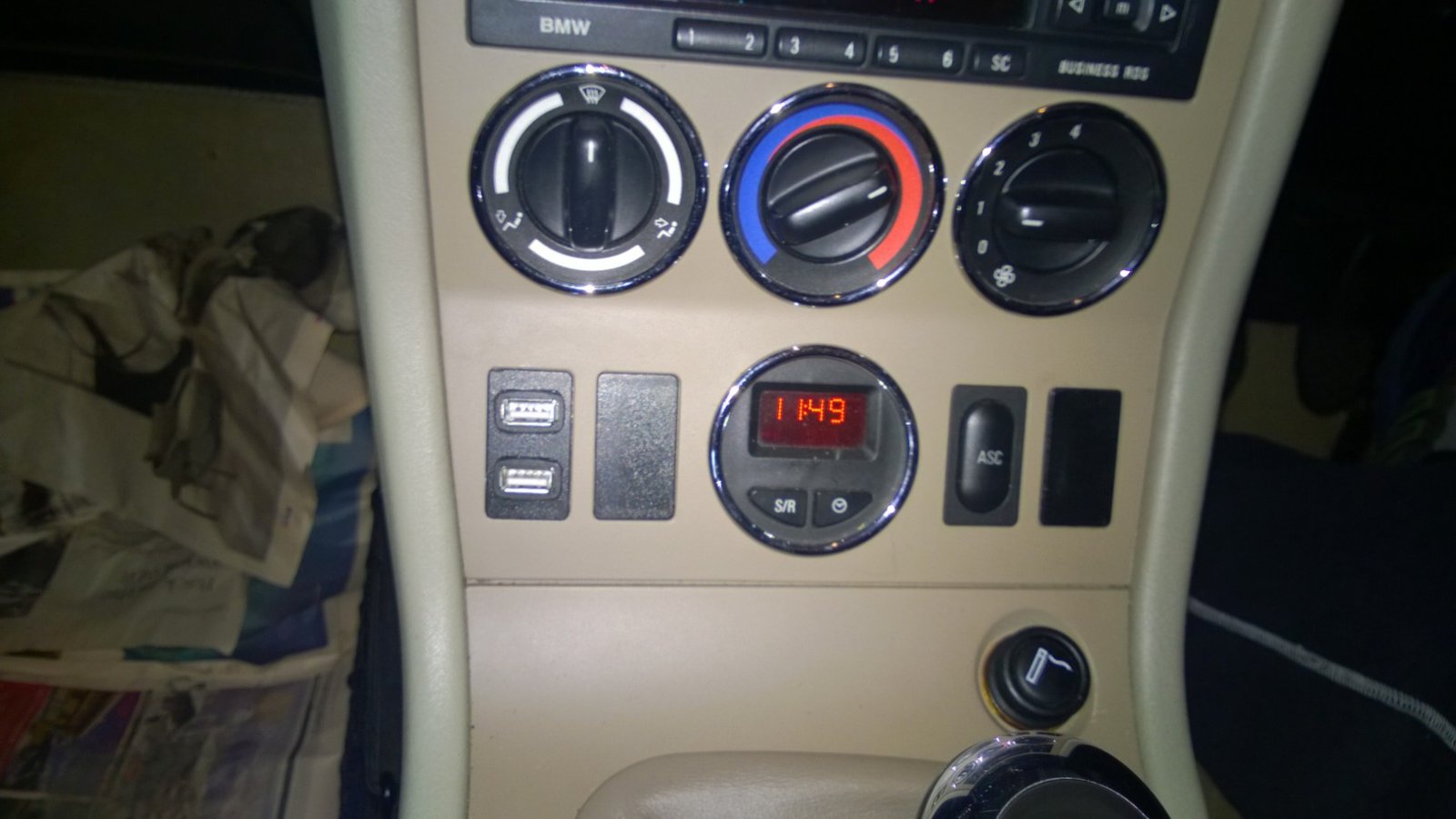

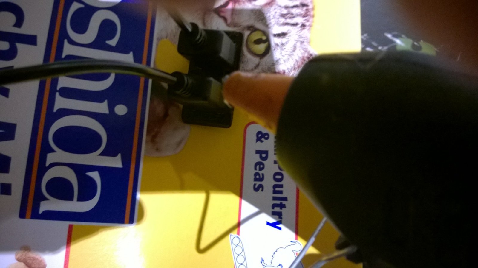

OK, job done, didn't get a fuse adaptor as I didn't want to have to run a wire into car, so just put 5 amp inline fuse to cigarette socket, pictures below, hardest part was just hand filing the blank plate, otherwise less than 5 minute job, and now sat nav and phone can charge without losing skin on knuckles changing gear and bashing the cigarette lighter adaptor

Great write up - just to confirm my assumptions - you bought the loose dual USB item from ebay and then made your own holes in a blanking plate for the USB ports to fit into and then you glued them into final place using a glue gun??
