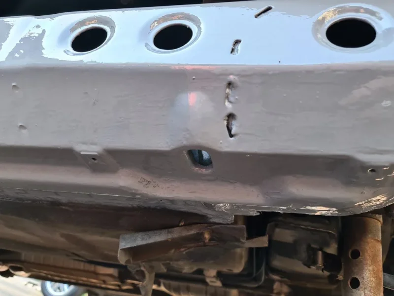

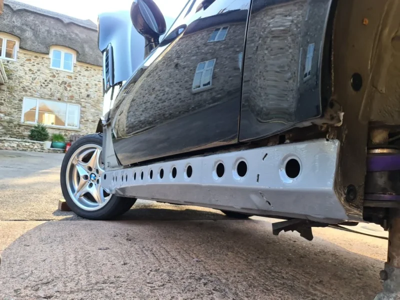

I have also taken the sills off, sent them off to be treated and repainted along with the quarter wings. Whilst that was being done I treated all the underneath box section using flapper disc, rust treatment and POR15 so it should be good for another 20 years. I was surprised how clean it was underneath for its age as I know some models such as e39s really can suffer.
