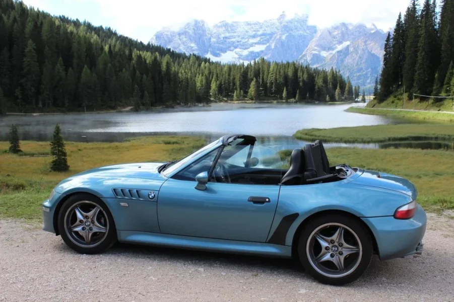

DutchScorpion
Dutch Zeds
Jun 23, 2012
158
Geleen - the Netherlands
Z3 1.9
I am not sure if I already asked to join the M44 clan? 7C841A96-A158-4346-A754-A257DBA0D34E.JPG
