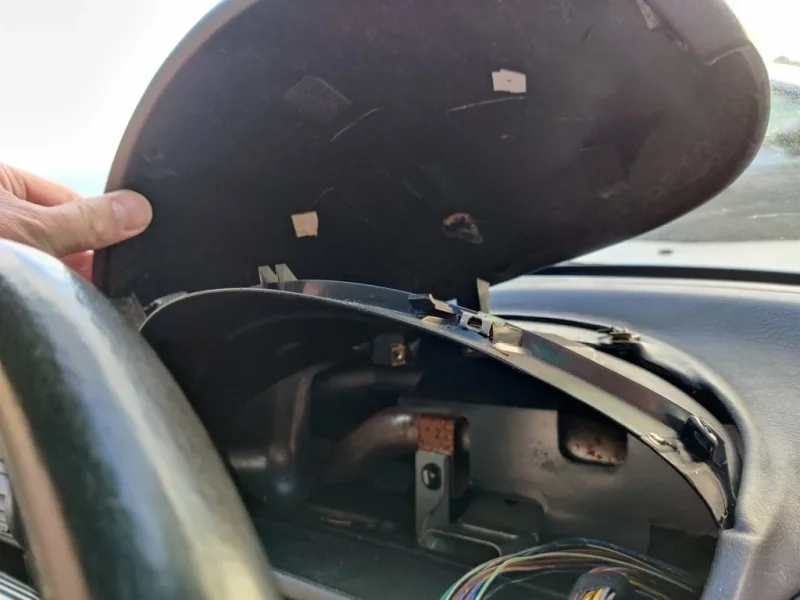

Great write up, went to use it to get get mine out and the previous owner had already found an alternative method. Barbarian the cowel off 🤦🏼
Need to find a replacement dash now.
I have a black and a beige dash available if you need one. I'm in Woking, Surrey
