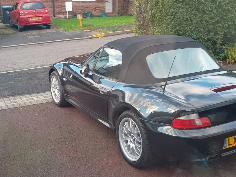

I'm yet to test it on a run in terms of reception. Some reports tell me that you need a smaller 'stubby' aerial to replace the standard 'whippy' one, but as I say, in my driveway at least it works fine.

Just need to sort the shrinking blue from the dash!
Got a better car cover for it now too.
Do you unscrew the whippy before you put it on?
The only downside…but yes - lives in the boot when covered up šŸ˜„
If I end up getting a smaller stubby aerial then there should be room.
