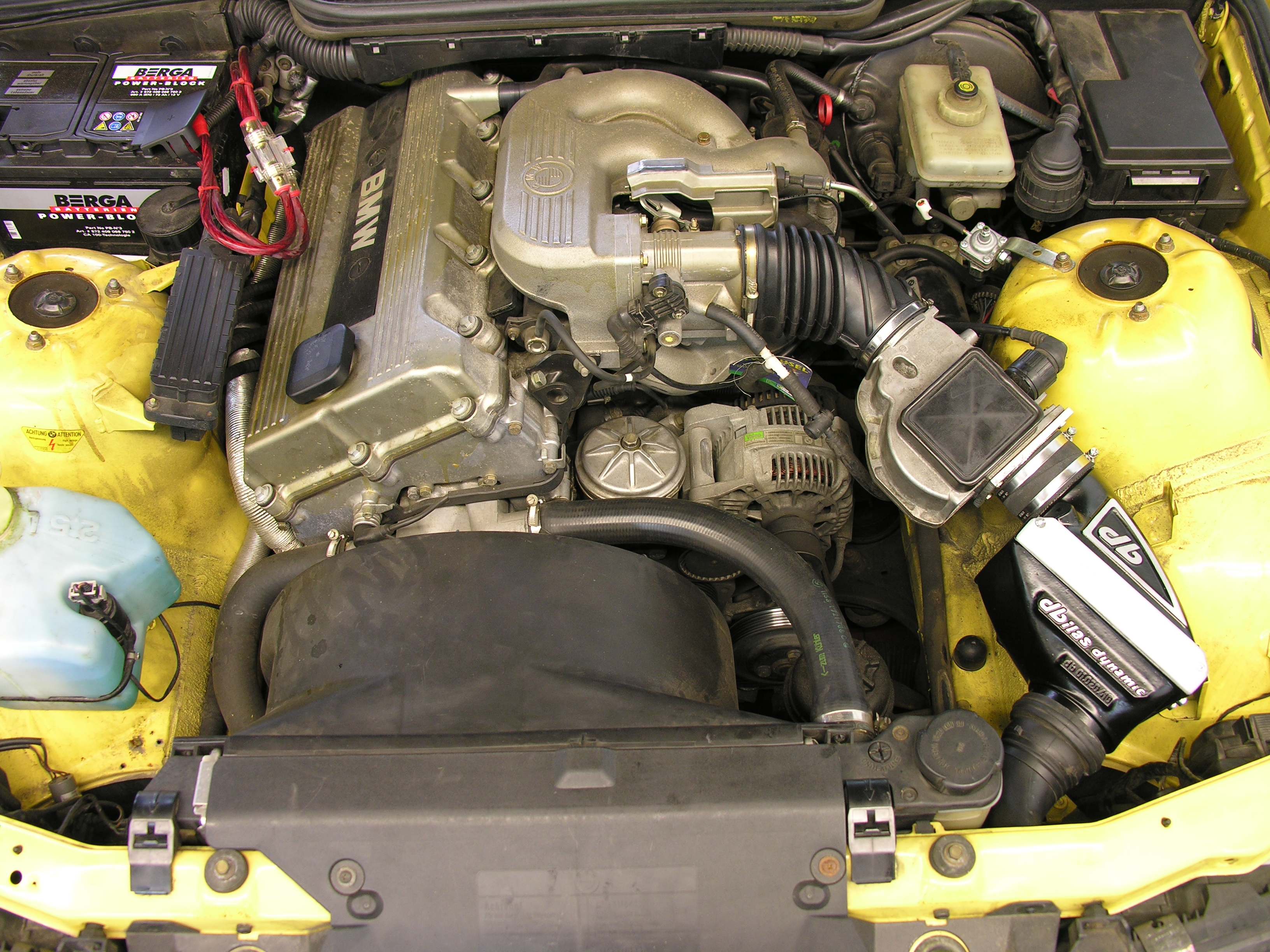

Another option instead of going down the M54 airbox route is to get rid and replace it with a K & N induction kit as per:-
Griff
Too scared to do this. Last time I had an after market air filter I oiled it too much and killed my MAF. Or at least that was what the tech told me.
unless somebody shows me how to do this effectively and properly I am afraid that another MAF would be on its way out.
Then you get extra noise and hot air from the engine bay.
I could use a heat shield or something, but living in Greece would make minor difference, the air itself has a temperature of 40c/104f most of the times during summer.
It usually ends up cheaper to buy a zed with a bigger engine if you want more power. These engines don't seem particularly tunable.
I am not after power. Just some joyrides with the top down. I was just thinking of alternatives to the stock filter setup. It seems that bmw will fork another 180€ out of my wallet for the oem hose or some samco silicone ones will do the trick.
The last time I had a really fast car did not end well. I know know my limits and stay within my safe zone.

so as I was having a chat over the phone with this seller, he told my he has a crashed Z3 with an M43 engine that has four single throttle bodies, an intake, a camshaft and a tuned ecu by a German company called DBillas and he will sell the kit for 1.500 €.
Checked that company online and seems well respected. Their (obsolete now) kit consists of all of the above claiming to be plug and play with an improvement of 30hp total to the M43/1.9 engine.
I got tempted, I admit and willing to make the 240km total trip to him just to collect the wheels myself and have a look at the kit.
anyone heard of this before?
I have no idea on what individual throttle bodies do exactly and not quite sure on how an ECU swap would be hassle free, but still tempter to give it a look.
what say you?

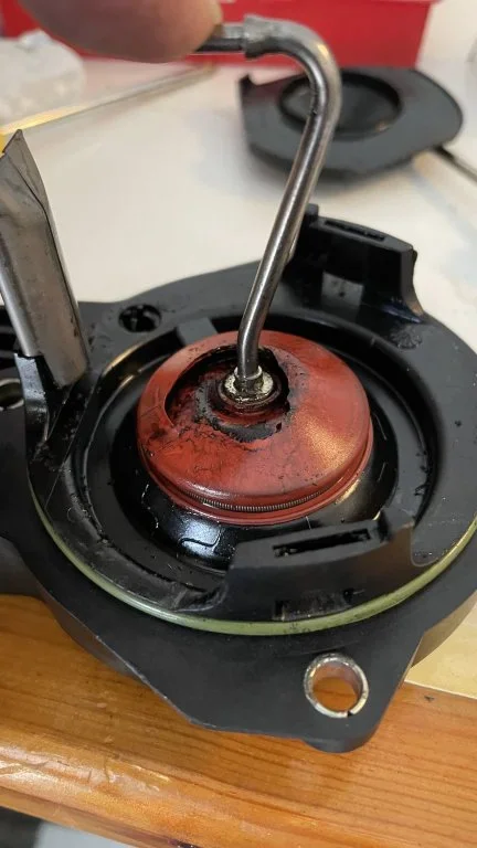

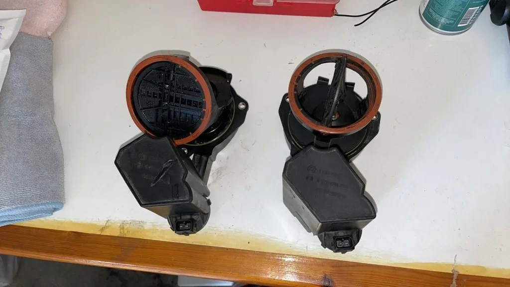

Clearly the Disa valve decided that its time has come.
this is getting out of control. I fix one thing and immediately something different goes bad and keeps me from enjoying this vehicle.
Really thinking of just replacing or refurbishing this valve and putting the car to the market for sale.
Even with such low mileage it seems that time took its toll on the various engine components and more trouble will follow.
on the other hand I am way too much into this and maybe I have to consider keeping it… but did not have the time to “love” it. So far it is a bitter relationship. Driving it for a while and then back to the garage for repairs.
Frustrated….

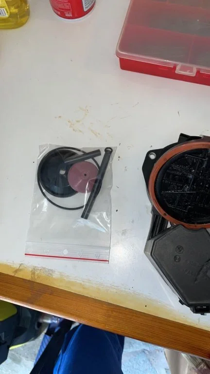

Ordered a disa repair kit from Germany. Seller has good reputation, sent over a youtube link with a video on how to do it (it is in Turkish but still informative) so waiting for the parts to arrive.

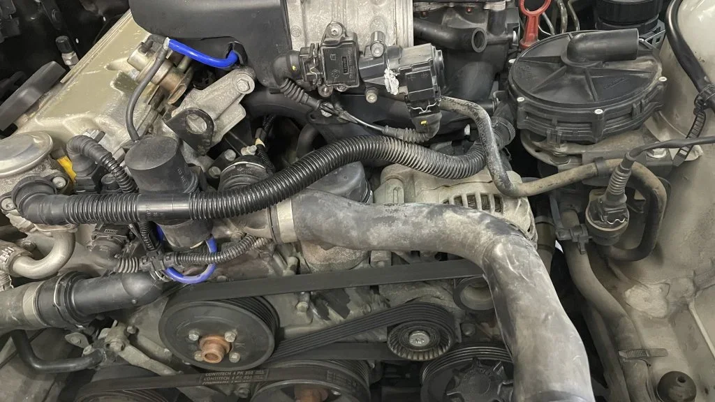

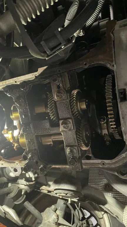

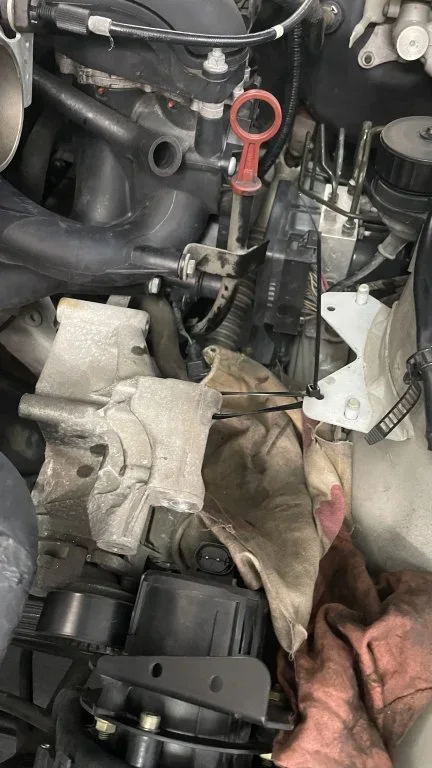

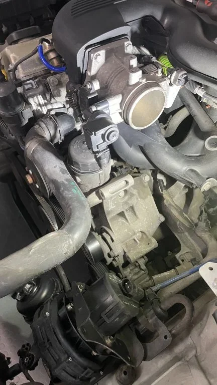

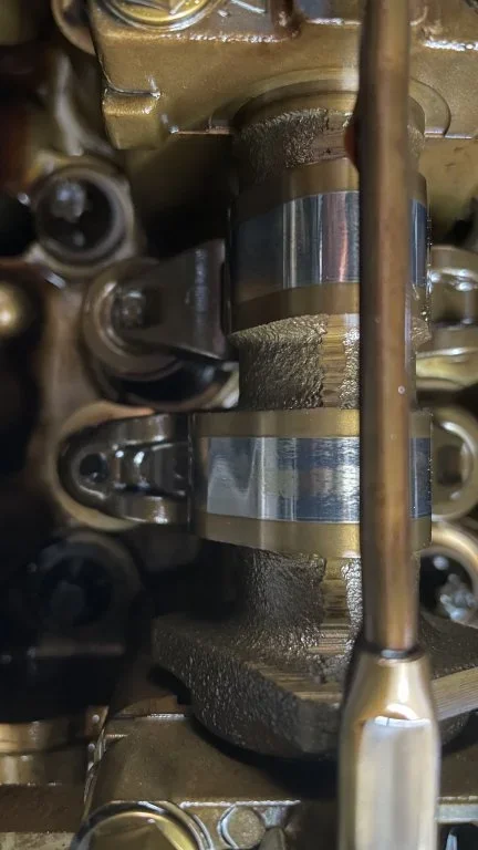

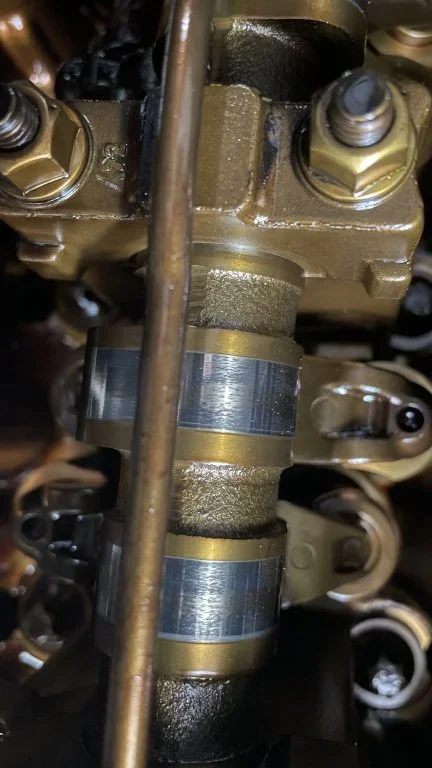

While waiting for the DISA repair kit to arrive,

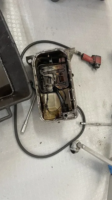

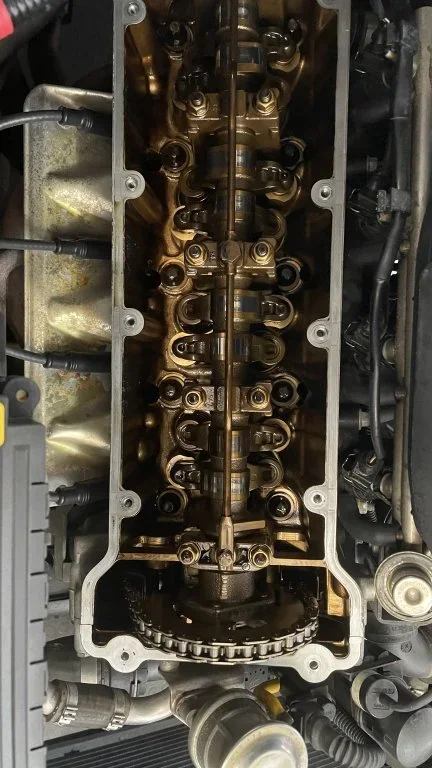

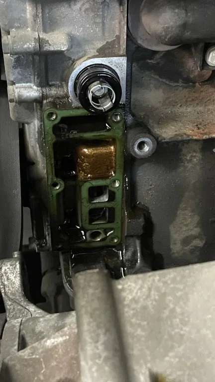

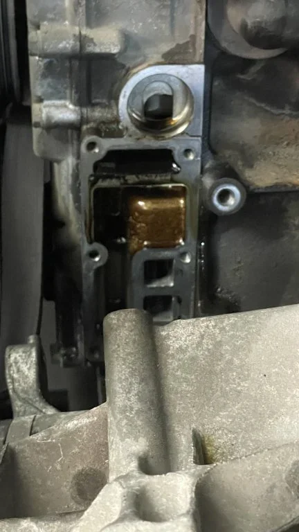

Here are some photos from the gasket challenge.
it was not easy. So much time spent for this, I really wish I had taken it to the shop.
but anyway, finished now…

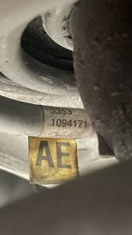

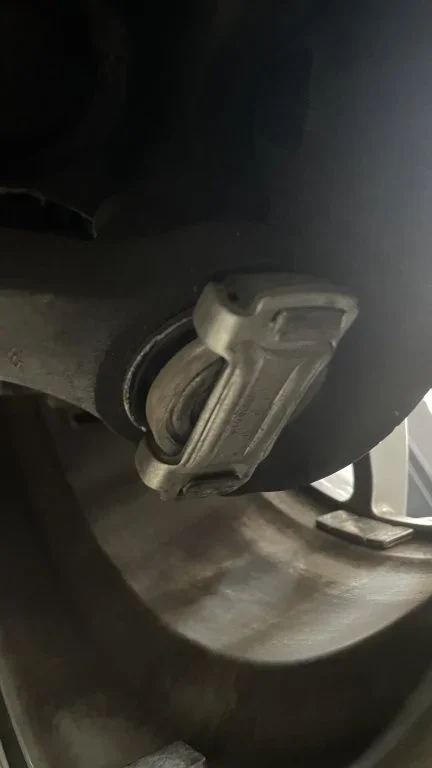

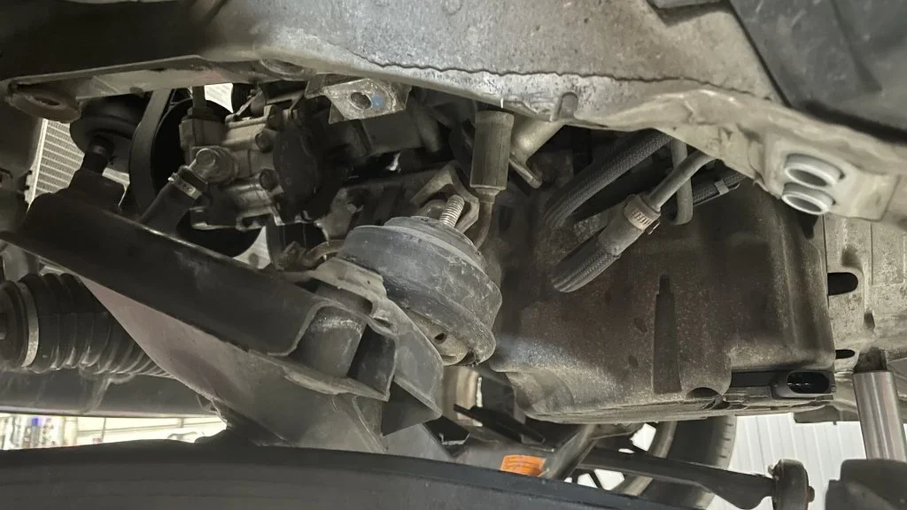

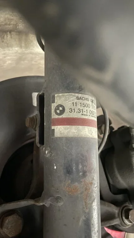

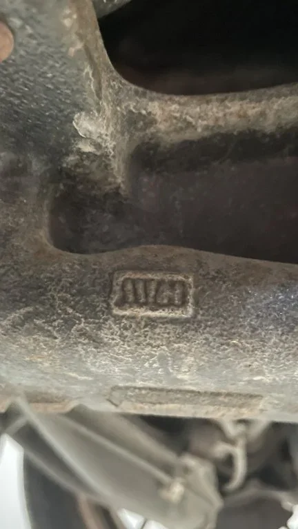

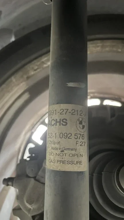

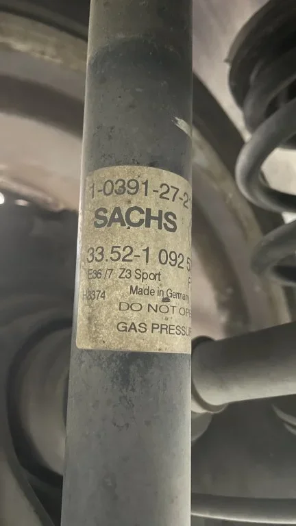

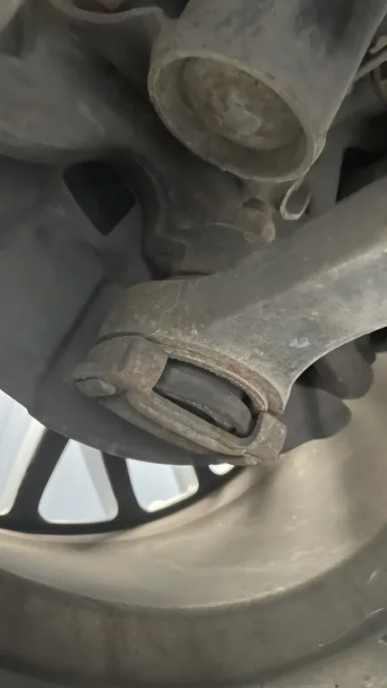

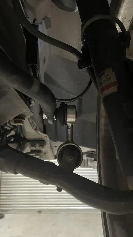

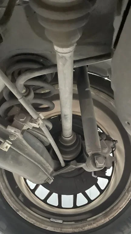

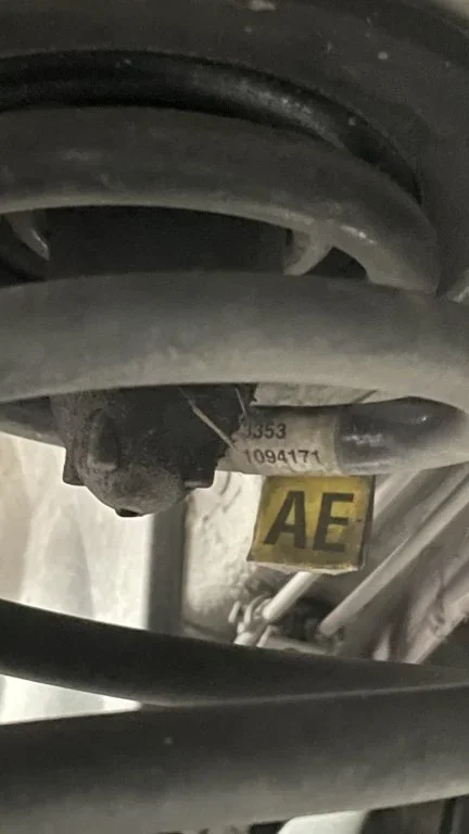

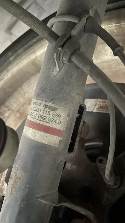

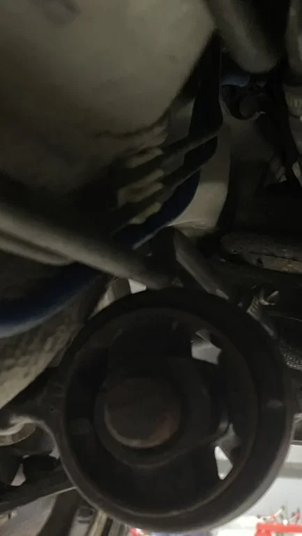

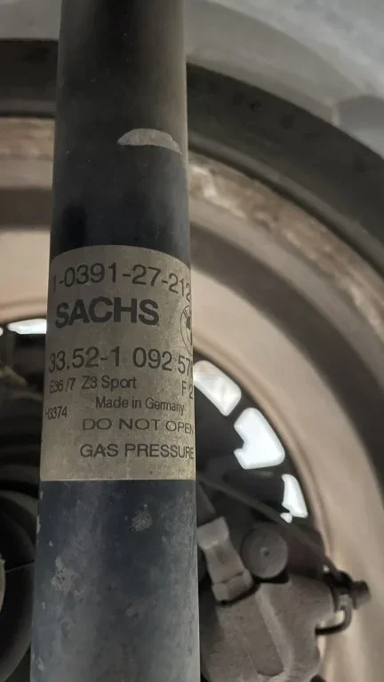

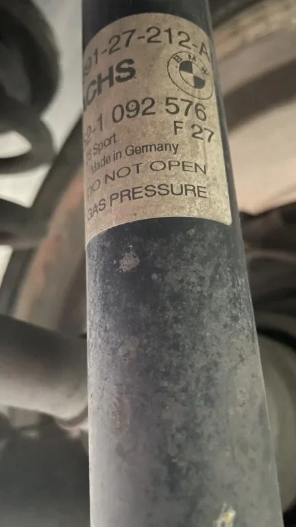

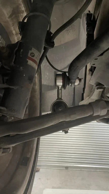

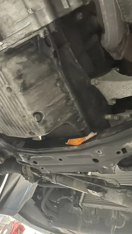

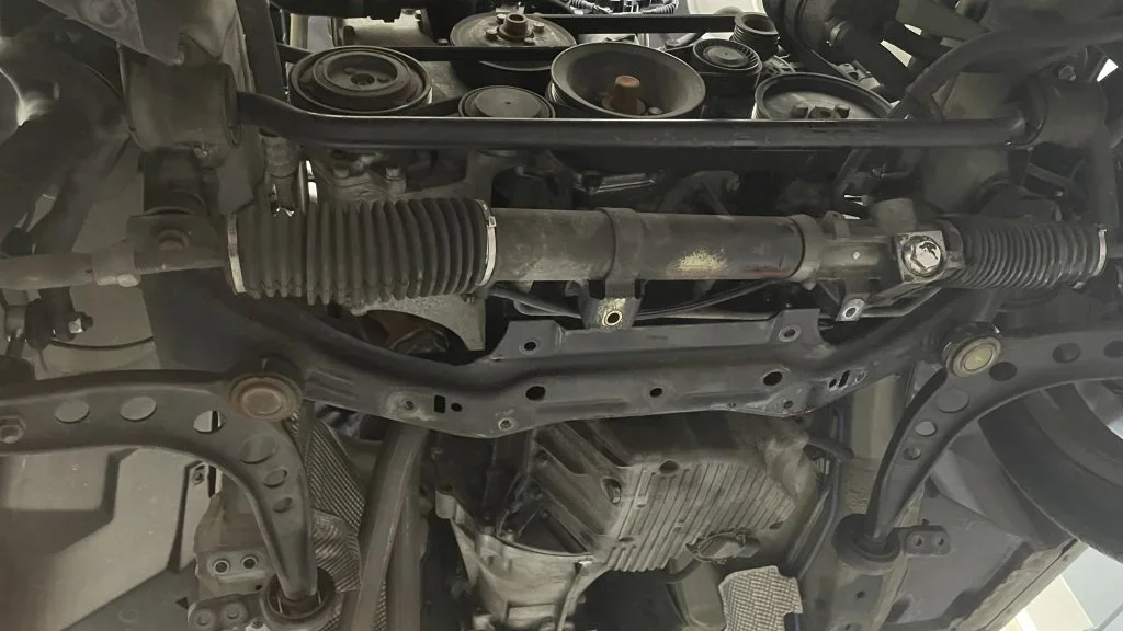

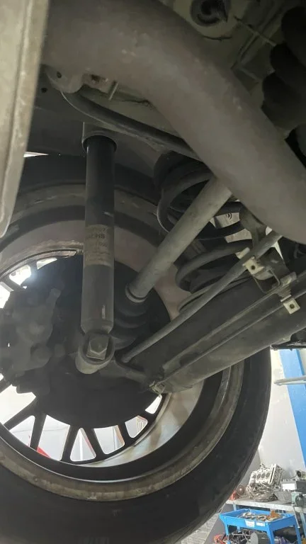

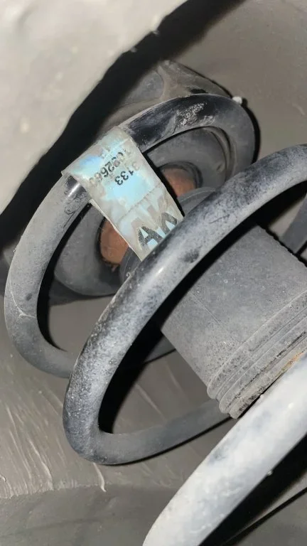

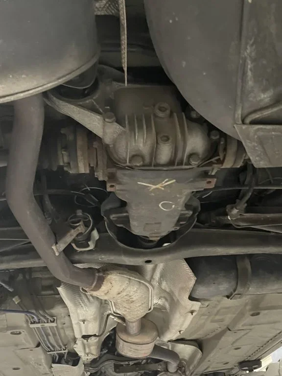

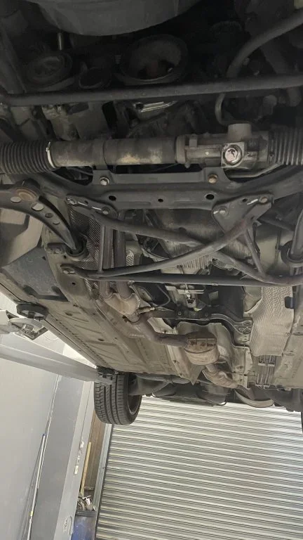

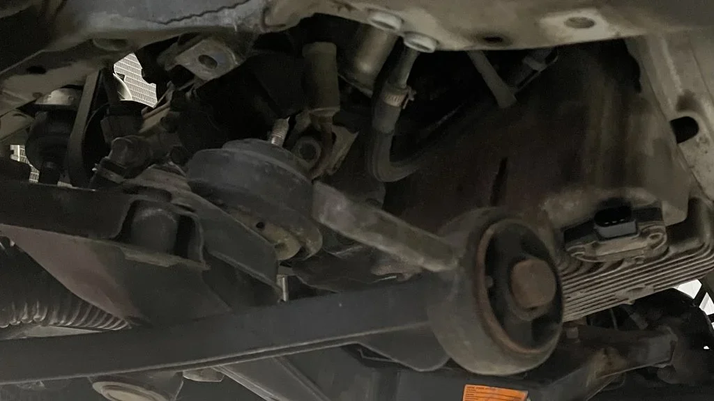

And some more from underneath and in case anyone was curious about the “sport edition” part numbers, I have written down each one of them.

Final post here as the Z is sold.
tried to fix the disa before giving it to the new owner using the repair kit.
unfortunately the plastic surrounding was so brittle that it broke to pieces.
bought a working second hand one and swapped it. All is fine now, no high smooth running values, maf readings etc.
do not try to repair a crusty disa unless you are extremely competent and have the proper tools.

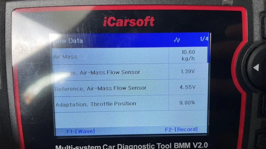

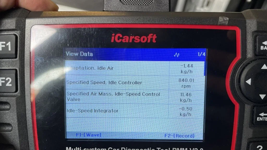

so.. the guy who bought my Z called and said that he has a rough idle during startup.
I told him to come over and we check together.

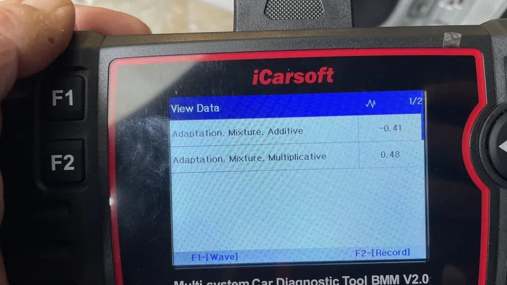

the Z has a new idle valve, all hoses replaced, new icv and as far as I was the owner I had changed everything I could think of so decided to check the injectors.
had the scanner plugged and the smooth running values were 2.25-0.30-0.28-3.11, so definitely something was wrong with the injectors.
Took them off the car, filled them with wd40 and put them upside down to check what gives.
Number one and four were dripping, so put them in the supersonic cleaner and gave them a good bath.
Then took a 9v battery, connected with wires to the injector pins, they started clicking and spray cleaned from the intake side them with carb cleaner.
now they work like new and smooth values read 0.15-0,17-0,19-0.13.
