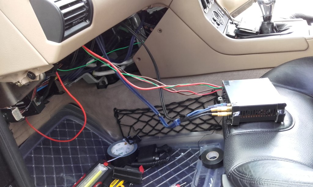

Now mine is wired and working giving me the extra bass fill in from behind I'd like to thank Susan for the great write up which spurred me to go ahead and build it, shame its taken me 18mths to actually wire it up. Here's what I achieved and hope others will now follow suit to get the sound which the Z3s without Harman Kardem system deserve and should've had.
If you look carefully you'll notice the port under the lower speaker grill, decided to go this route because no one else had. Wether it actually helps the mid woofer perform is debatable but I like the sound and being no expert this being the very first ICE I've built. Did use two amps, one Alpine KTP-445A intergrated with the Alpine head unit and Hertz speaker upgrade designed for the Z3. Plug and play amp with only the location to worry about. Thus under passenger footwell was easy install for me.
The second amp was a Bass Face DB4. 2amp to run the Pile Gear X 6.5inch mid woofer. (amp sitting on passenger seat ready to go up under passenger dash where the later air bags are fitted)
This amp needs a seperate feed from the batt but I wasn't prepared to go from the boot so here's what I did and works very well as the amp will not draw feed untill the head unit is switched on and that's governed by the ignition so wasn't unduly worried.
As seen there's a short run to the in line 2amp fuse then (nice new red 8amp wire) on along the bulkhead firewall to the washer bottle down behind it to spare unused grommet lower firewall, pierced it to take feed wire into passenger footwell then up to Bass Face amp under dash, much easier and quicker than from the boot. IMO.
The speaker wire from the new mid woofer was partially installed before mounting the woofer box into position hence availability to conceal its route to the passenger side where it travels under carpet to footwell keeping it away from interference from main wireing that runs along the centre tunnel.
