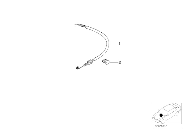

It could be a broken Bowden cable to the regulator flap?
Z
zedonist
Guest
Well both heater and air con systems are controlled by flaps, which control the input of air from outside or inside the car, I think on modern cars it is called the circulation for inside sir, anyway this is the difference between cold and hot air, on our cars, this is done by a wire attached to a flap and the dial the turn, if the wire or mechanism is broken, the flap will not turn.

ok got what you mean on older cars you had a cable from the control knob to the matrix, that controlled the flap, but i thought the z3 might have been controlled by power, not cable,

A lot of the Z3 is taken from "older" BMWs, so tend to have fairly basic operation. Cables, pulleys and mechanical stuff galore. Probably just as well because electrical stuff tends to be harder to fix...

Well Z3 are not modern cars they first came out in 1995, nearly 20 years ago, the design other than exterior did not change, modern cars have servo motors on the flaps, the Z3 has cables, which us good because they are cheaper, if that is what is wrong..........

could well be as there is no feel to the heater knob thats why i thought it might be electric, will have to find some time between doing the kitchen up before winter comes on, better hot than cold this time of year,:happy:

not sure were to look busy in the house at the moment as soon as i get some time will check it out, but from what as been said so far it may be a cable as there is no resistance at the control knob

You may be able to do it without removing the centre console, but it will be extremely tight, using the side access panels and the radio slot, and for the pain, IMHO, it's not much extra just to remove the console, it's then just like replacing a bicycle brake cable.
