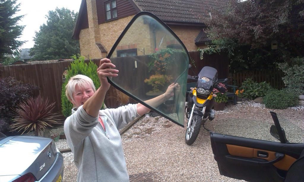

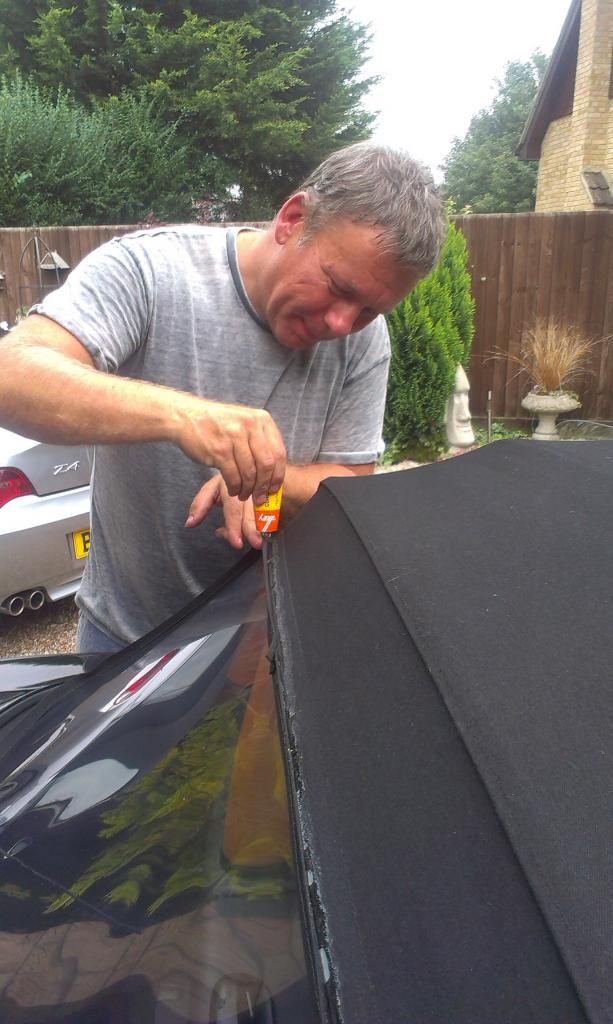

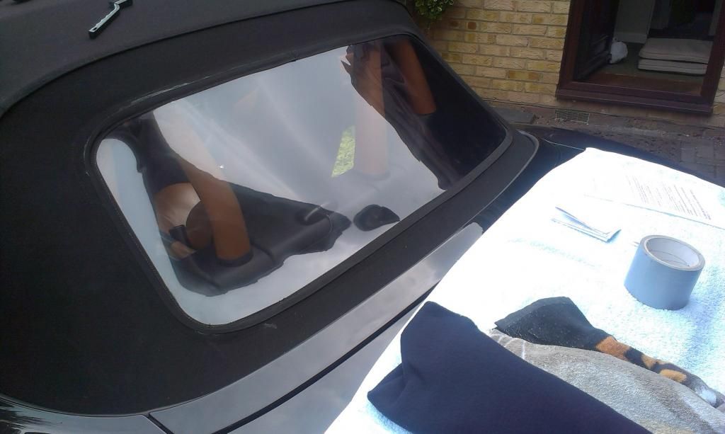

    Cheers gazhyde, we put a new rear screen in it on Saturday, never attempted it before & took about an hour or so, much improved & very satisfying

    That wasn't a zip-in, was it? I have to do mine soon (a zip job) Frankie

    Hi frankie, yep it was a zip in screen I got from eBay for just over £70, very pleased with it-seller states they are not genuine but reckons they are a superior American plastic, time will tell......

    Looks a good job. Was it damaged, or just wanted something you could actually see through? :watching:

    Bit of both, had turned opaque & also had a vertical split in it, I've now removed both of the rivet type things below the roll bars as I discovered the screen scrapes them as it's lowered into its hold, the wind cheater clips onto them as does the tonneau cover, both stay put fine without them luckily.

    You did well, Mr Smartbear, :cool: there's many a Zedder ended up tearing their hair out trying to put in a replacement rear window, it only takes one or two teeth out of line and the job turns into a nightmare!!!:eek:
    You must put a folded towel/tea towel along the outside crease of the window, every time you put the top down now, so that the frame doesn't rest on the plastic and scratch it.

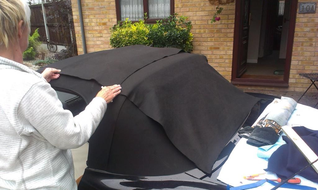

    Hi mike&sandy, mrs smartbear has got some fleece and sewn in some rare earth magnets which stick to the soft top frame so the fleece stays in the right place as the roof is lowered

    That's a good Idea, BMW also made a special cover for the rear screen.
