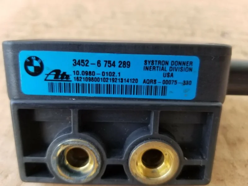

It's probably one of two sensors under the passenger seat. One is the speed sensor, part number 34526754289 and is black plastic with a blue label, and is £400 plus from BMW.
The other is the acceleration sensor, part number 37146781405 and is about £150.
I've JUST sold a good used 6754289 but should have the other one.
