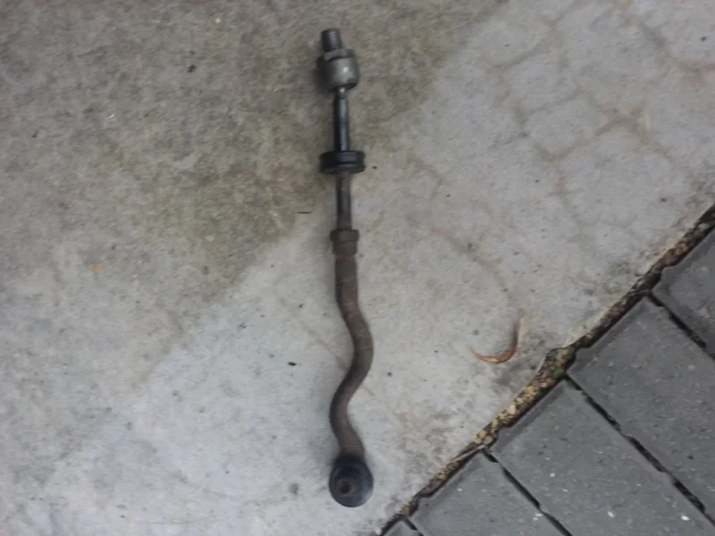

The lower arms look new as do the back P bushes only really leaves the anti roll bar links and the drag link from the rack to the hub, but again no feedback in the steering indicating any thing is amiss its all tight im thinking may be ball joint is tightening up but its difficult trying to listen for it as i need someone else to turn the wheel while i try identify it....
