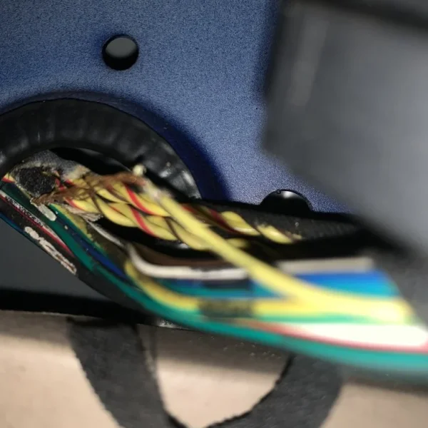

Right, update.
found these chewed wires on the passengers side behind the glove box. might explain the clicking around the fuse box area.
Now I hate electrics! Before people say I need to look at wiring diagrams etc. Can someone tell me is this a cluster of cables that could be unplugged and replaced as a whole?
The prospect of splicing wires upside down in a foot well doesn’t appeal!
