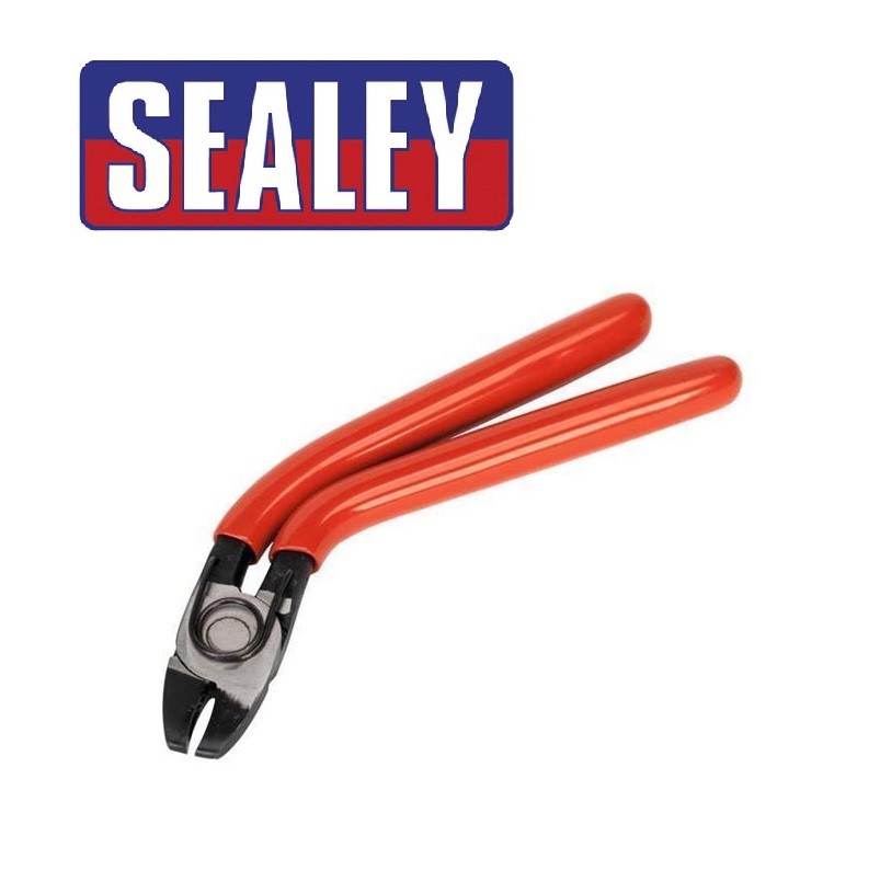

I retrofitted heated seats to our E36 323i convertible last year.
1. Hog ring plier kit (with 100 or so rings) was circa £20. You cannot reuse the hog rings, they have to be cut off. Take care to get all the bits out or you could have short circuit problems in the future.
2. I used new BMW seat heaters, new switches (which control things) and a BMW wiring loom (are available for retrofit).
Not the cheapest way to do things, but it is OEM standard.
You can spread them to remove using a pair of external circlip pliers. That what I did, then easily reusable.

bold statement alert !
I reused mine.... and didn't cut any of them off..... as in the write up
Your article refers to 3 hog rings at the front of the seat, there were at least 30 on each of my seats, no way they could all be reached with plyers. Some you could hardly see as they were "buried" in the foam. Whilst the E36 seat is likely larger and a different design, the hog rings tie the leather to the vertical and horizontal tie bars embedded in the seat foam giving it it's "pleated" shape. Maybe the Z3 seat is different to the E36 seat, I have not had experience of doing these as my Z3 and MC have factory heated seats. If my experience is of no help, so be it.
