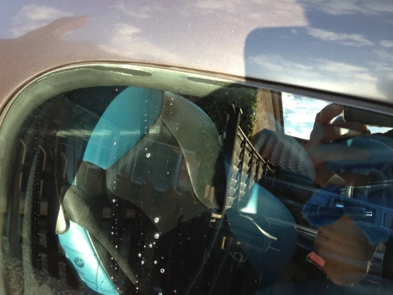

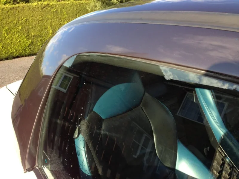

Hey guys just wanted a bit of advice. I've put my hardtop on again and it doesn't seem to sealing very well against the rubber and leaking in. To me I think the window is too high and possibly wants adjusting down a bit at the back. What do y'all think?

Had a go at sorting this today I've raised the rear of the hardtop up which helped but was still leaking in. I decided to take the door card off and lower the window down and voila no leaky anymore. Also treated the rubbers to some gummi phledge if that's how you spell it :happy:

Yeah if you take the door card off and lower the window you'll see and Allen headed bolt to the rear of the window mechanism. To lower the window you wind it clockwise and vice versa.
