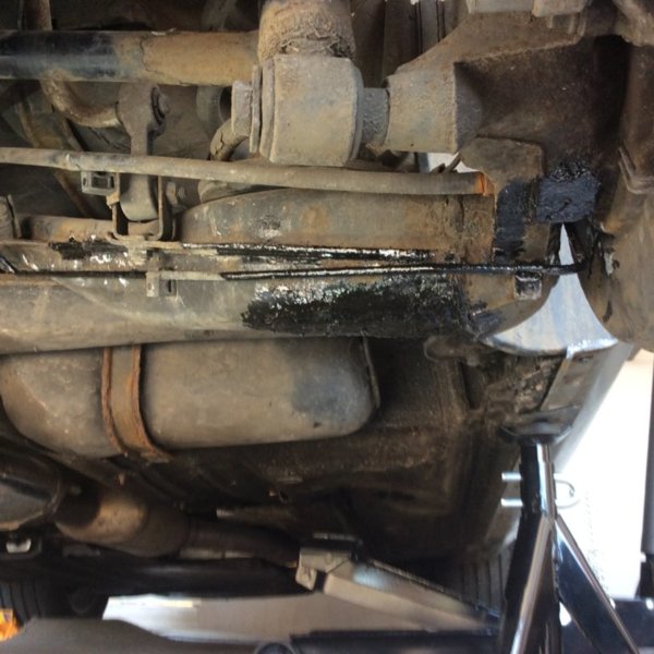

Mot advise......’ corrosion on offside rear brake pipe’ so jacked up, removed wheel and had a look.
Yes a bit of surface rust but nothing major, so cleaned, treated, undercoated and painted.

I’m not sure how paranoid the advice is. But I’ve often read you shouldn’t clean up a brake pipe, particularly by rubbing with emery cloth as it will weaken it and/or it’s already weakened once corrosion appears.
You may also find you go from one advisory to another as there is one that says product/coating applied to brake pipe.
But then I’ve just spent an inordinate amount of time replacing the entire system on my 3.0. I’m on my second roll of kunifer pipe. And it takes quite a lot of practice bending the pipe and flaring it.
Tight bends one after the other with kunifer are the worst. And it would bring me out in spots if I didn’t try and copy the factory bends :)
Trouble with kunifer pipe is that it work hardens, so, if you don't get it right the first time it's almost impossible to re bend it again.
