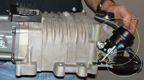

I have an Eaton M21 laying around somewhere. It has an internal bypass controlled by an actuator on the side. It diverts some of the outlet air back to the inlet side to control pressure. The air is recirculated since it is already passed through the air filter and MAF sensor. If it was just wasted it would completely throw the air fuel ratios out the window.

The MAF is measuring engine air before anything else and the ECU adds air accordingly. If you wasted part of this air then the ECU would be adding fuel at the wrong rate.
The internal circulation on the Eaton supercharger is very simple. It is just a little flap like the one in a carb that allows the boosted air to go back to the inlet side of the supercharger.
