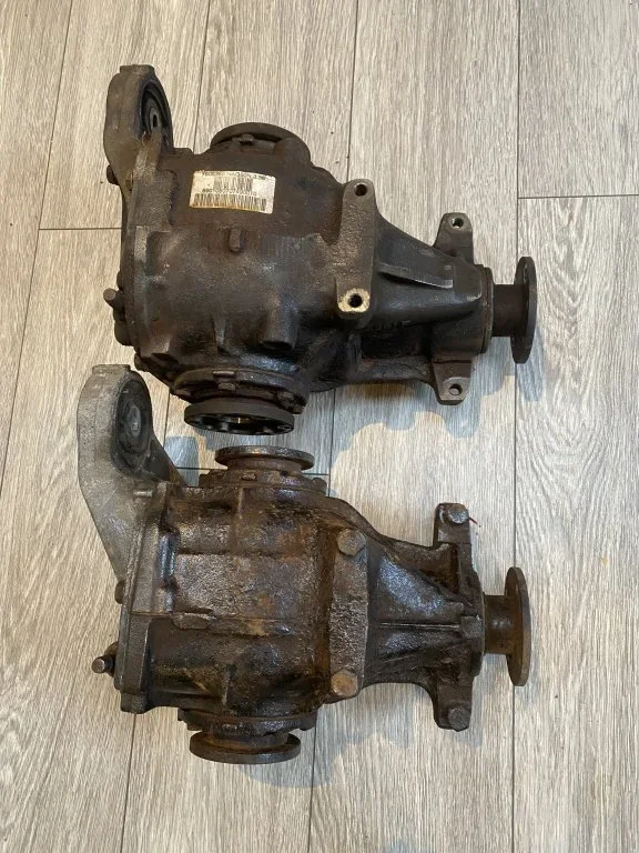

The prop should be okay. Unless you have a Sport with the LSD, the 2.2 168 diff is 8mm shorter. You should be okay but you might have to fit the 2.8 front half to the 2.2 rear.
Tbh I think you’ll be okay just fitting the 2.8 prop.
