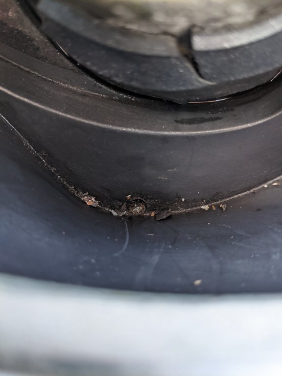

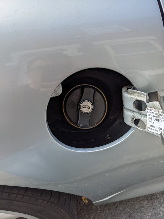

So first one and biggest one. I found petrol outside the fuel tank locking cap.It looks like
there's also a hole in it? I don't know what a good one looks like but why would there be a hole?! To be fair I don't know if that hole goes all the way
through but I can't fine any other explanations for the gas being there.
I was driving a bit too fast around some corners in some back roads before I noticed that so it could also be my cap not dealing properly?!
If anyone has any experience with similar issues please tell me if this is serious and my fuel tank needs replacing or if after drifting this tends to happen.

It looks like the filler cap is past its sell by, try Andy @spurs fan in a coupe he may have a used one. He may also have a mirror too.

New cap for sure, the small hole in the surround is a water drain, yours looks well blocked, it runs in a pipe to the bottom of the car and drains out under the sill. Best get some thick strimmer line and poke it down the hole to clear the debris thats blocked it. Once clear pour some water down it and check it drains freely underneath.
