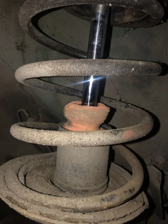

Mine's foam and suffering after 25 years on the road. An online search reveals hundreds but none that are to me 100% certain to fit my 1998 Z3. Can anyone point me towards the correct (and maybe more modern?) version?

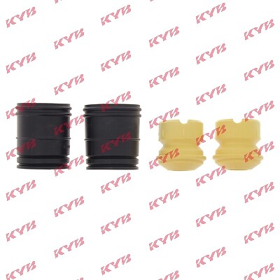

Thanks guys; already I've learned here that they're a 'dust cover' and not a bump stop, so a search for that gave me a lot more options.
That's all that is holding back refitting my new front struts, I like doing things properly (including replacing the front brakepad wear cable that someone has cut off and which will annoy me until refitted.)
The actual bump stop is the orange coloured part which fixes inside the black plastic gaitor . Take note how yours comes off.
