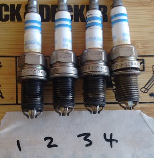

I took the car for a run up to Rutland Water last Sunday and it ran sweetly with the fuel consumption looking better after the Terraclean. There was very little traffic on my drive and I took it easy on more or less motorways, but when I was near home I could again smell fuel when braking into roundabouts. A week of work has got in the way since, but this morning I have done some investigation.
Starting with what the mechanic told me at the Terraclean place that I had slightly too much oil in my engine. What he didn't do was smell it, which I have now corrected- yep it smells of petrol and is quite thin. I have carried out a compression test with no problems identified- all 4 cylinders are between 180 and 195 psi. Hopefully someone can confirm this is ok for my engine?
One thing I did notice was the difference in my spark plugs, bearing in mind I have blow-by going on (no black smoke or petrol coming out of the exhaust) it was interesting to look at the plugs. These were in new about 750 miles ago:
IMG_20160325_104150751
Note that cylinders 1 and 2 are very dark and wet, cylinder 3 slightly drier and cylinder 4 very dry. Which is interesting as the fuel pressure regulator is next to cylinder 1 and it is this that I suspect is faulty as my fuel isn't shutting off on the over-run. Can anyone confirm this 'logic' please ?

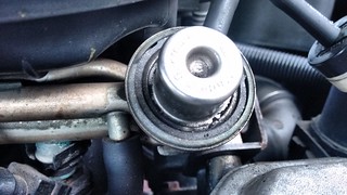

When it comes to the FPR this is mine
IMG_20160325_084112618
It's secured with a circlip and the manual says after taking this off it should just twist and pull off, but I can't seem to get it off. It twists and I've applied a reasonable amount of pressure to try and get it off but I don't want to force it. Is there a knack to this??
Can't help with the fuel press. reg. but re the compression figures I'm not sure what you would expect on a new engine, not a great deal more I suspect, but the main thing is they are fairly equal 15 psi over 4 cylinders is acceptable. I would also be having a really good look over the vacc. and inlet rubber items to make sure they're all in good order. The fuel pressure regulator should maintain an even pressure along the whole of the fuel rail so shouldn't be responsible for excess fuel in the cylinders, only the injectors and/or the length of time they're open can do that.
I'm happy with the compression test and it is what is causing the overfuel that has me scratching my head. I was hoping for an easy fix and thought that if the FPR wasn't shutting properly then the fuel would still be getting into the cylinders, but I get what you're saying- the injector(s) has to be faulty to allow the fuel past anyway?

I remember some years ago having problems with my bmw k100, it run well, but the oil level kept rising, had me baffled, checked everything I could,then asked at motorworks, and they suggested the fuel regulator, I bought a used one, off them, and problem solved, maybe worth trying on your z3

It's going into an injector specialist on Monday for them to look at all of the fuel system
