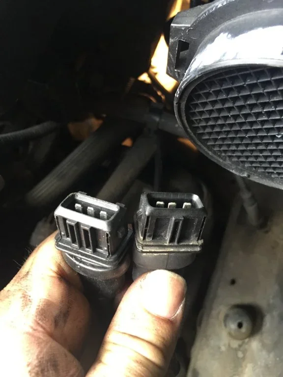

I give up! Old sensor out, new sensor about to go in when I find out that the connection is different. Aaarrrggghhh! Monday back to the parts shop. Not the most fun, but hopefully when I come to change it, I'll be a lot faster.

That's bloody unlucky, there can't be many more options.

Exactly what happened to me - Mine looks like the one on the right in your picture - I ended up with a part by Intermotor (part19141) - fitted and works a treat - had a lovely blast last night collecting the Friday evening Chinese with the top down! Keep at it! it will be worth it.....Nige:thumbsup:

The one on the right is the original BMW part. I'll see what the parts shop come up with on Monday.
