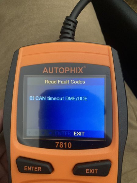

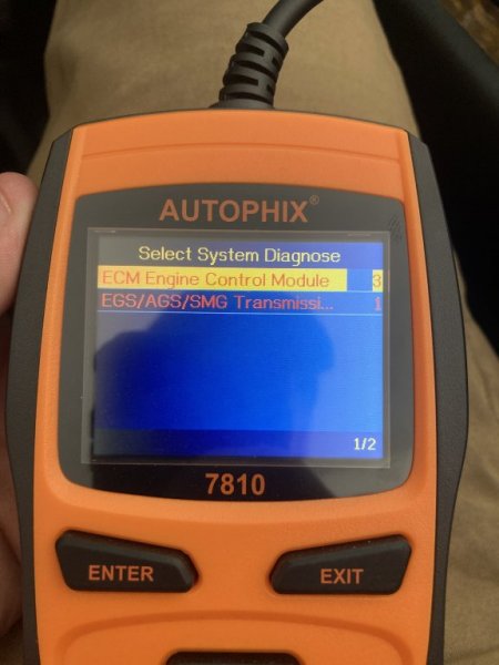

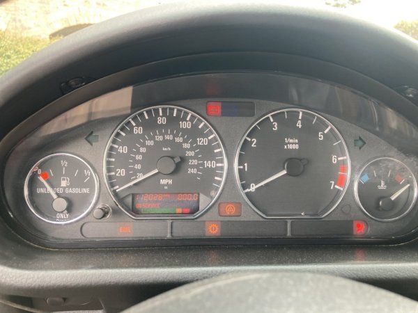

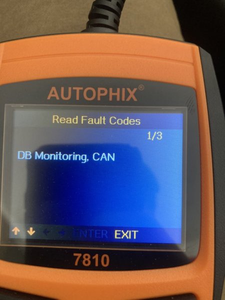

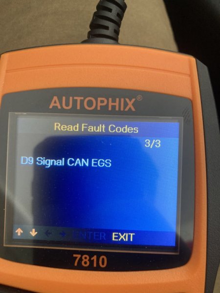

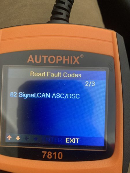

Hi i bought this z3 acouple weeks ago and just now got a my obd scanner in. Here are the codes it’s throwing. Any help and advice is greatly appreciated.

The engine doesn't crank? The last picture is, I think, the main reason. Timeout of the DME. I think the connection has been lost from the alarm/immobilizer.

The DME (engine computer) can not talk to the EGS (auto transmission computer). There is an electrical fault.
Get your wiring diagrams that match the build date for your Z3 from the "Resources" section of this forum. See blue ribbon at the top of your screen.
Check fuses. Check connectors that sort of basic work. Had a rodent nest in the engine bay/wiring?
Checked all the fuses, all came back good but I think I might be missing some (2001 z3 3.0i)
