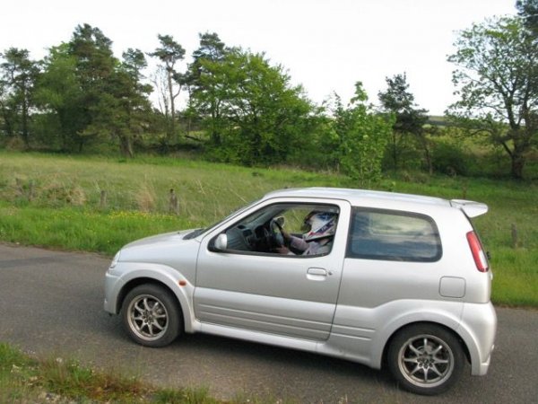

My Ignis Sport runs on LPG, fantastic fuel. Real world it gets 94 mpg equivalent to petrol cost.
I bought it converted, took a while to get it to run how I want it, as the professionally installed system was a complete bodge job.
The Iggy feels ever so slightly faster on gas. As Rory says, less calorific value, but higher octane, so any knock sensing system will advance the ignition. It burns hotter, so a slightly lower thermostat is usually a good idea. Some cars it anneals the fire rings in the head gasket, the Ignis started drinking water about 85K, ran it like that a while, changed it around 100K.

There are lots of folk who'll tell you not to cold feed an airbox with lpg as it'll cause freezing problems. Load of utter bullocks. I have the Ignis on Sorn at the moment, but I have the temp sensor bridged, it switches to gas after 30 sec. I've only frozen it once, that was when it was down at -14C, you're unlikely to get those temps down there. Straight out of the village onto the A9 it switched back to petrol, I just pulled into the first layby, sat there a minute on petrol, switched back to gas and it was fine.
