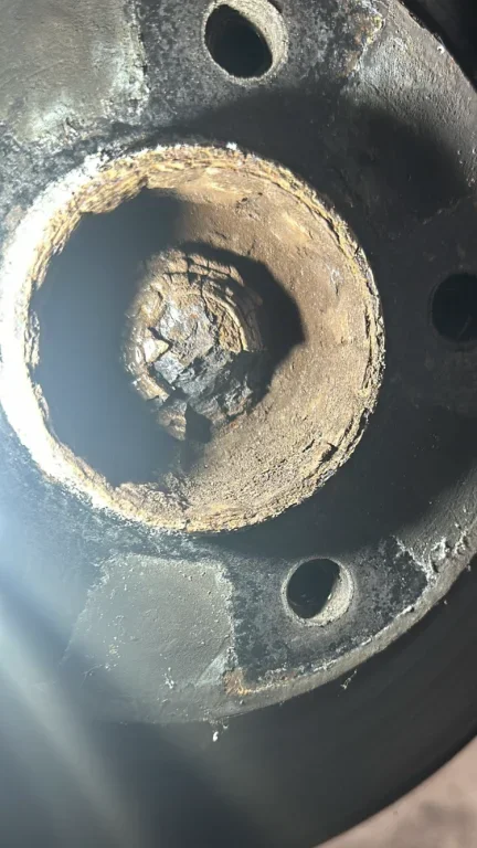

I've broken a 15 ton puller on it (now fixed) and we've given it some large smacks with a 7lb sledge hammer with a drift.
It's off the diff and hanging down, resting on the exhaust and the nut is loose.
Has anyone got any top tips for removing the driveshaft?
I don't plan on replacing the bearings, so don't want to use heat, but this may be the last resort.

Holy sh..., that hub is gopping.
I can try to get enough heat into it, but I'd be surprised if I can make something that big glow red. I've got oxy-propane with a 315 nozzle.
Don’t think you’ll be reusing that wheel bearing 😂
