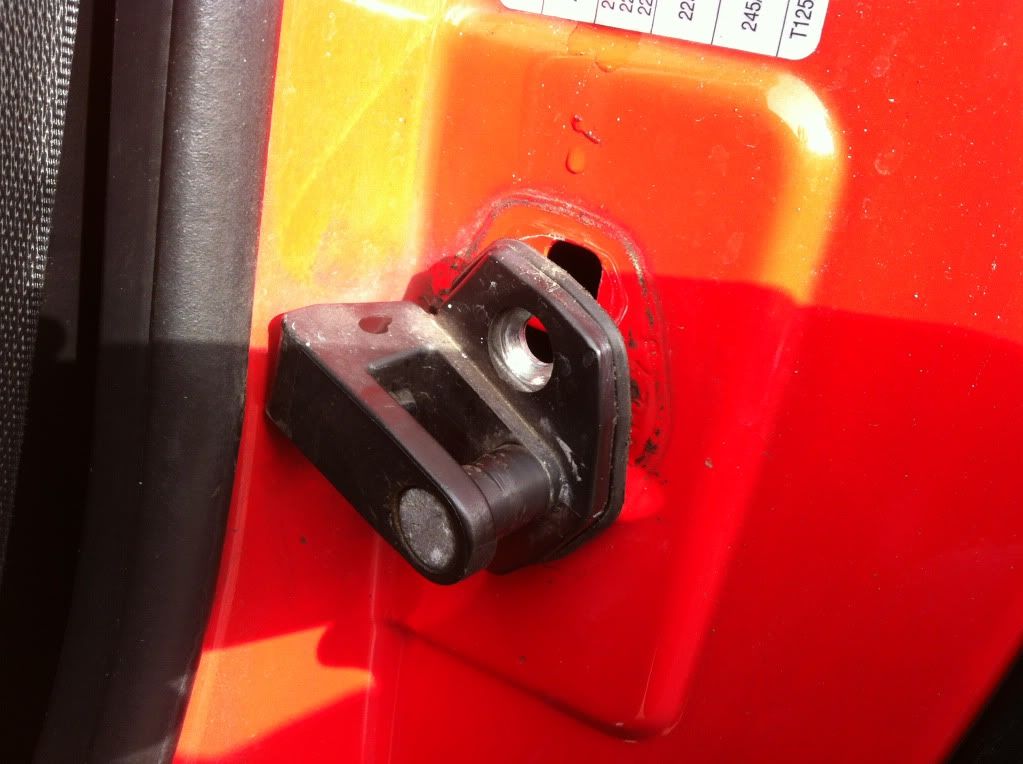

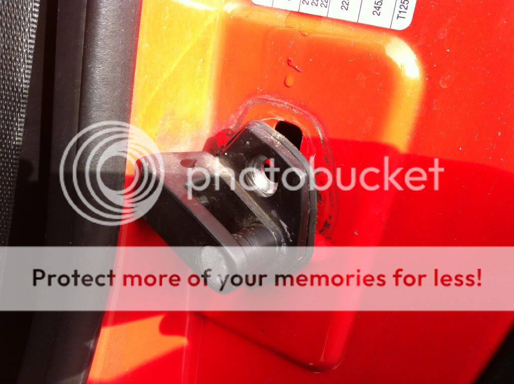

Knuckle scratching to change but easy enough. Some photos below.
Loosened off, but try to keep the backing bracket in view, I used the bolts that came out, not a problem until the wire is removed.

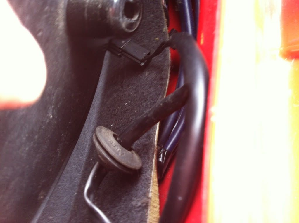

Wire connection found and unplugged, one phillips screw behind the seat

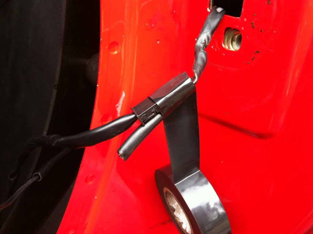

Cut old wire off at latch end, taped the new one on to guide through the hole.
Pull it through, re-assemble!
