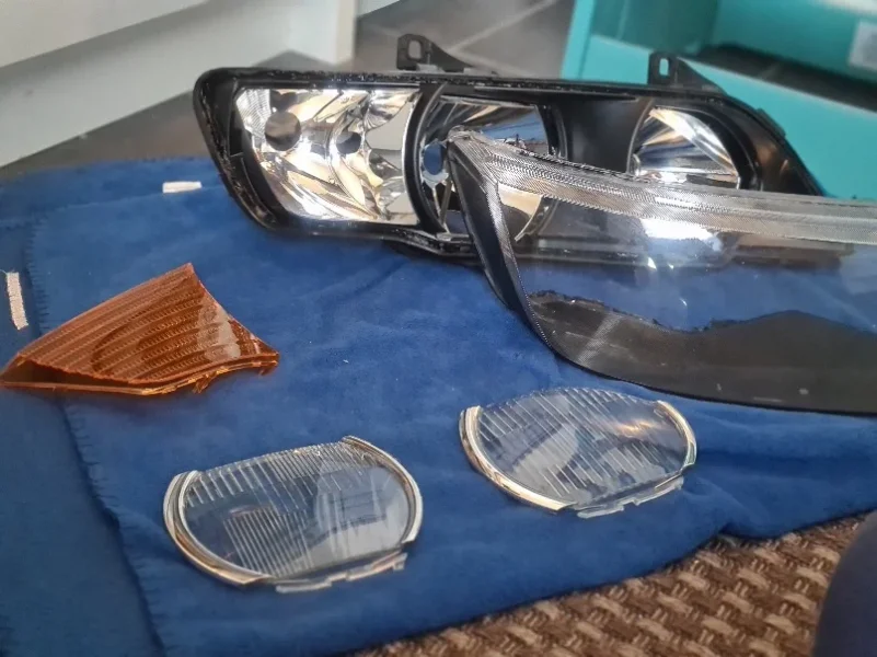

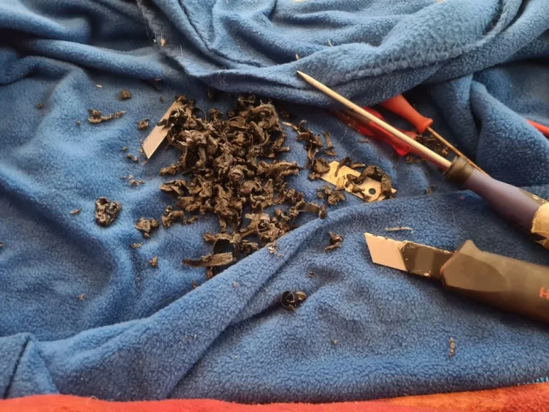

I opened 2 pairs of headlights lately. Had them in the oven at 80 °C for about 15 minutes, absolutely no problems, I had the feeling that they could endure even higher temperatures without problems.
I scraped out the old glue and used some fresh butyl cord so they should be even easier to open next time.
