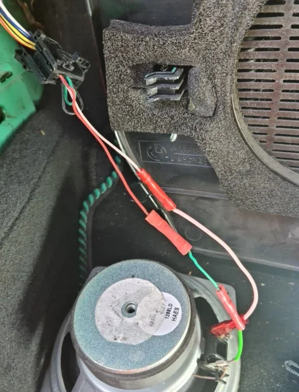

I've just done this bypass today and can confirm it works. I chose the option of NOT cutting the harness and used electronic breadboard wire to "poke" into the terminals. Then knocked up some longer leads for the speaker. Tidied up the mess and buttoned up the lower dash and all good !

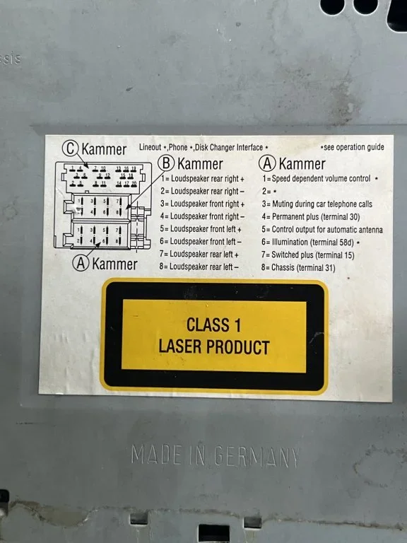

Can you post a photo from the pin setup of the becker and the plug you are using? Is it an iso to bmw one?
Here’s the Becker. The other is iso to BMW, yes.

It will be a pain but you will have to check your harness to make ends meet.
Checking that wiring from A to B connects as it should.
If this is ok, and only the left front (passenger for UK) speaker does not have sound (and all the others have) try the old headunit and check with that.
My approach would be to check ends meet first.
(Front l to front l, etc).
Maybe someone has a better idea. Sorry I cant do much more.
The thing is that front left works with the other Becker (same diagram as the one I just sent) and right front do not. That’s why I think there’s maybe something with the radio itself.
