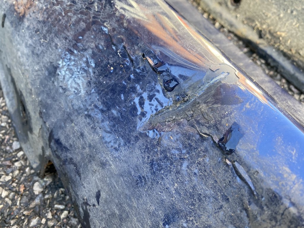

Little update for Dino’s build. So he went and tore the arse end off his rear subframe. It’s known in the Zed community that Dino has the meanest gear change in the community so it was only a matter of time.
The damage was very substantial, diff hit the tarmac and broke two fins off.
as much as I would love to have a go at welding this I found a local welder who came over and worked his magic.

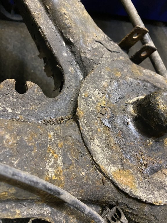

Nice juicy update. We removed the subframe again so we could 1) remove the old spare wheel hanger & 2) fit the new subframe lifter bushes and support.
the amount of times we’ve had this subframe out over 10 years I’m considering wing nuts :D
Now gives us room to test fit the extra ear
now with the subframe out the way we can remove the hanger
And it leaves a nice bit of space
took some going to get this off

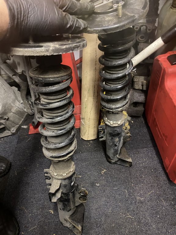

it even took a 15ton press to remove the old bushes. These go in by hand normally.

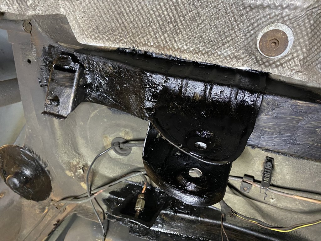

so this support hanger is designed for the E30 with the thinner cross beam so one side will fit the other will need welding. Will be worth it though just for the extra support.
front aligns nicely so we’ll trim it and seam weld on 3 sides.
the rear plate well fold and trim plus seam weld. Watch this space
So finally got a welder in to help with the bracket install. This kit is an E30 kit so needed to be modified to fit the Z3 beam. It’s finally in and holding strong. The bush offset kit we can visually see already that it’s taken out some of that rear camber.
nice n solid and grey primer coated
can see the offset bushes and spacers.
