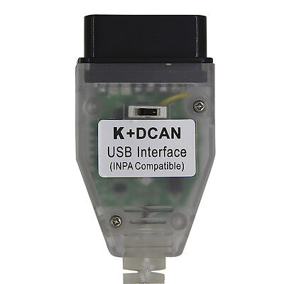

From reading the cable I needs It seems this is the one;
(it's from UK)
Does it seem right to you, if so I'll order.

Seems that on a 1999 Z3 you can do tiny mod to the 20 cap in engine to access the full modules from the internal ODB2 port, so don't the the 20 pin adapter. Anyone know if this is legit?
I have the 20 pin adapter that fits under the bonnet at a point I can’t recall as I write this but it has limited capability and @Mint used his PC with relevant software loaded on it to sort an issue I had with my Z.
I'll order one of the adapters and install the INPA software and see how far I get. :)
The cable is fine.
Yes, you can either:
  • Mod the 20 pin connector cap to get all modules though the OBD2 port, or
  • Buy the 20 pin to OBD2 adapter
Most people just buy the 20 pin to OBD2 adapter.
