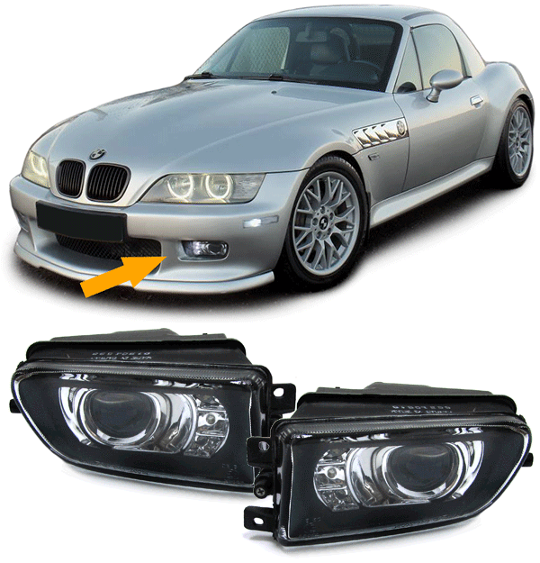

She looks fantastic and lights work well with the colour with their slight tint. Do you remember where you found the lights as so many I have looked at are two big for the space next to the spots.
Interesting thought to see if existing fogs can be converted to DRLs. Tim
g8jka
178
Telford, Shropshire
Z3 - 2000 2.8 Roadster
You can get fogs with LED's in which could be used as DRL's. Theres a few sellers that do them but I don't think they are cheap. And most seem to like using my car to promote their product :mad: wouldn't be as bad if they offered me a set, but wouldn't give me anymore than 10% discount and they still worked out over a hundred quid.
Tim Palmer
Jul 28, 2017
34
North Yorkshire
Z3 2.2i
Yes saw those on a site I found but they described them as parking lights rather than DRLs. Even though they looked to have LEDs in the light cluster. Yes also seen over £100 but look good. Did you fit with self dimmer system.
