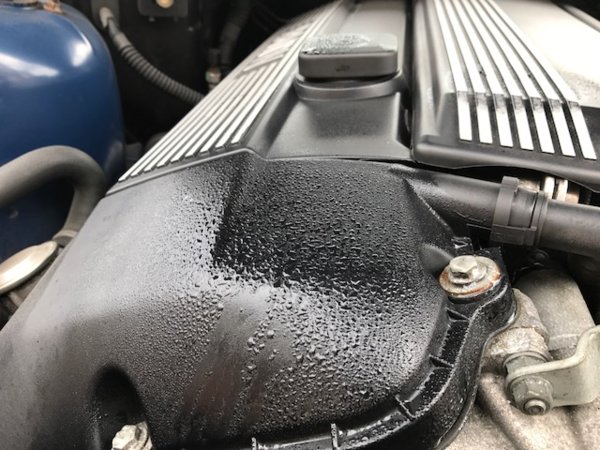

Good Morning guys
Don't know if it's still related with the cut liners but I just realised this yesterday before I even went for a drive.
Is this water siting on the engine bay from previous drives ? and making loads of condensation over night?
Even the sound proofing on the bonnet felt quite wet.
Any ideas?
Pretty sure I will contact some of you for prices on the liners by the end of the month.
