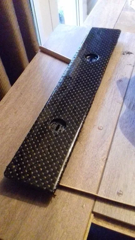

I will definately look into it, and i am getting close to that now, cut away all the extra material next is to bullnose the fins front edge only.
It's turning out OK so far... :thumbsup:, the top one in the stack is actually the bottom one on the car...

A special thanks to @IainP , for some great input.. however. I'm going with the glass cloth wrap for the following reasons.
After researching the alternatives, I decided that.
I'm too chicken sh#t to try something new on this project, matching the weave patterns across the elements would be beyond my abilities. Also I already have the cloth the resin, and the clincher is, SWIMBO would like to it the same colour as my stone chip prevention on the rear arches..So I will wrap them when they are done.. I,ll glass them on the morrow, and post up the abortion for you all to laugh at.. assuming I can still open my eyes..
