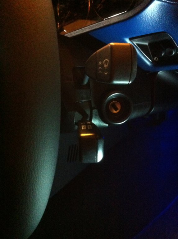

I now have Cruise Control fitted and working, Purchased the Interface from Soper (10% discount given and free postage £48) The Stalk and knob came from ebay USA seller. Once I had all the parts the job is easy but fiddly, trying to work upside down in the driver foot well is not so easy at 64, still keeps the body bendy. Quite difficult adding the connector to the connector stack because it needs to go in the middle of the stack so you need to release the middle connector by pushing in the clips, again easy to do if you could get to it. I had to use a cable tie to secure the interface as there was no bracket on the accelerator control.
All worked as it should, really pleased to have another gadget to play with. Thank you to @Low Rider for pointing out the USA ebay stalk and thank you to @t-tony for his help with getting it to me.2017-05-18 15.05.19.jpg
All worked as it should, really pleased to have another gadget to play with. Thank you to @Low Rider for pointing out the USA ebay stalk and thank you to @t-tony for his help with getting it to me.View attachment 56143
Your welcome. Great to see you've managed to achieve your goal.
