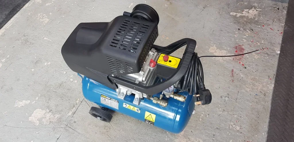

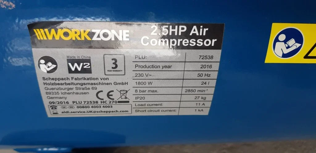

I have a compressor for sale:
25litre, as new can bring to Santapod next week.
£40.
