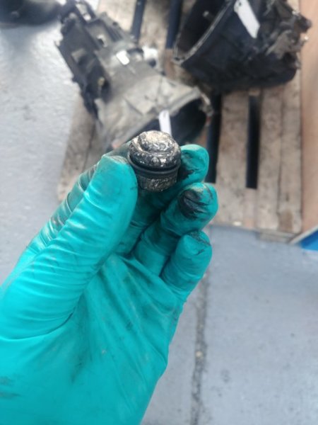

Just got the problem with the box to sort now. Had it looked at today. Needs new seal and mail bearing.
Surprised how many places won't touch bmw gearboxes.

Whilst it's all off I'm doing it all as the work involved was horrendous to get the box off, worst one I've done so far.
Changing to a SMF was going to get a lightened ACT clutch and flywheel but the cost of box repair has stopped that plus i don't it's worth it on that engine.
The dmf seems fine but i don't trust it. Might as well replace it at 125k miles while i have it all out.
Got the engine out too for a rebuild.
I only did the slave, hope i never have to do the master now lol.
The tranmission place said it's the main bearing plus it needs new seals.

I won't even attempt to mess with it.
Dropped it off at DMD transmissions in Wolverhampton this afternoon for them to fix.

Found a chunk of alloy in there. Wondered why it started making a clattering sound.
Wanted to up load a vid of the shaft problem but it won't let me.
