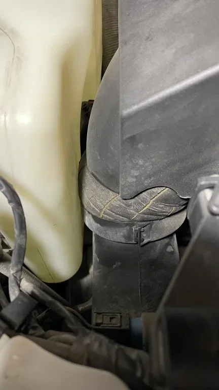

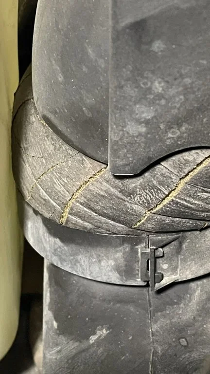

I am trying to identify this rubber/foam boot that's part of the cold air intake. I have looked at all sorts of parts catalogue without success.
It's connected between an air scoop behind the driver's side front grill
And the plastic shroud above the radiator

It’s completely shot, and I don’t think it’s even got the retainer I can see in your pic…

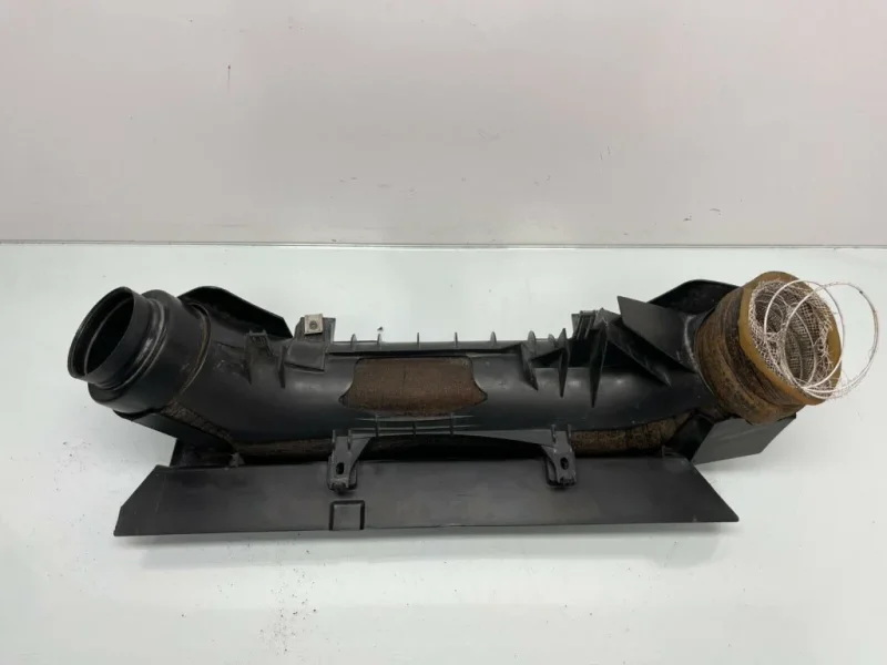

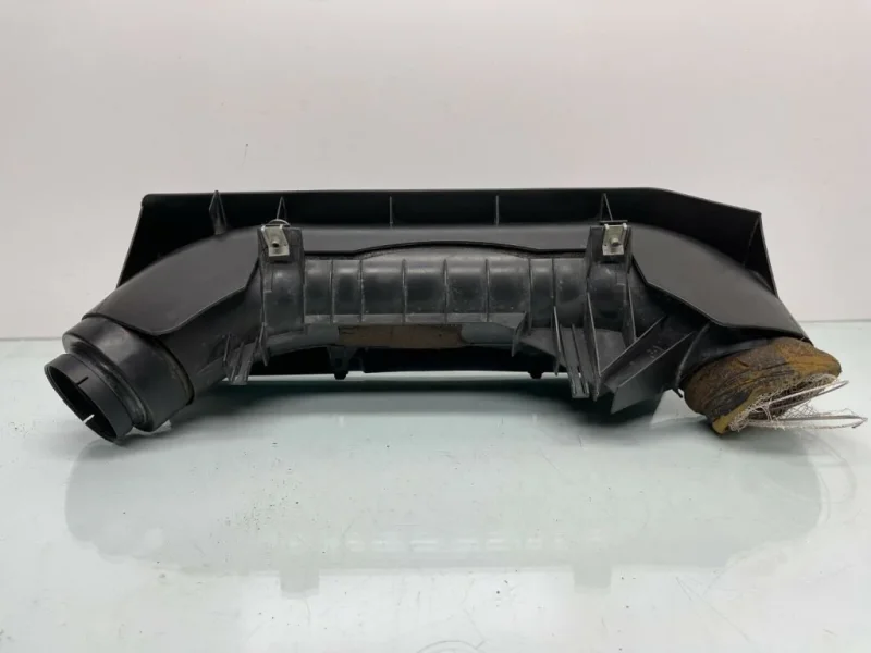

Well, number three on that picture looks like the intake hose, but nothing looks like the rubber boot I am looking for… I suppose the item is just part of the intake tube. The part I am after is something between parts 12/13 and 3 above. I am just not sure if it's sold as part of 12/13 or 3...

See in the picture above number 3 your hose at the end ( beside 12/13) you will see there is a line just up from the end that is the rubber end bit that pushes over 12/13 it is part of the hose.

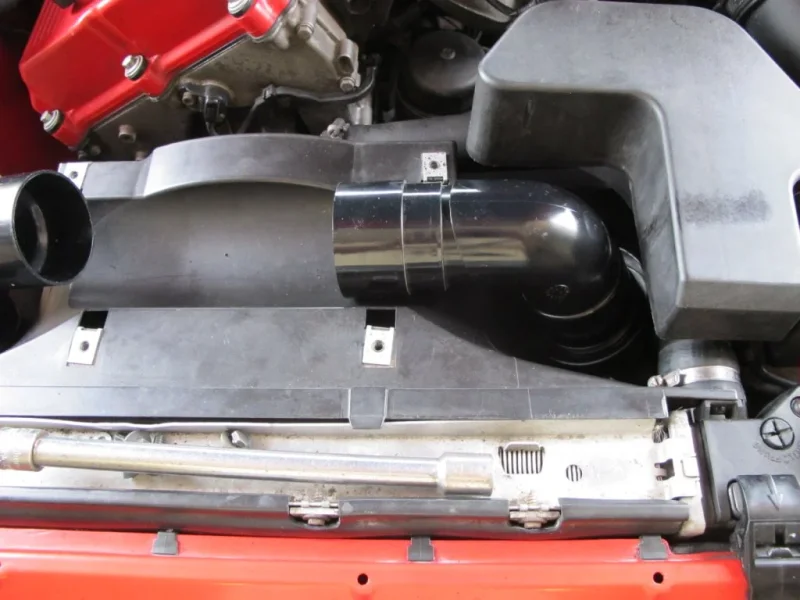

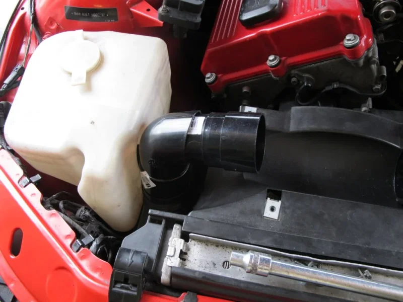

This will make the purists cringe but you can do a cheap fix with rain water pipe and a few elbows from Wickes - see pics. Remove the spiral winding and slip a section of pipe through sleeve and slot in. Did mine ~6 years ago - no problems with air flow.E228C7FE-CAFE-4F41-9A5B-5312298760B2.jpeg
I like that Colin :thumbsup:
