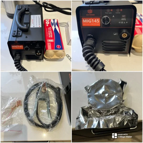

I bought a reel of flux core wire from Lidl to run test pieces, my mig can run both. A discussion with a mate at work morphed into buying the cheapest possible flux core / no gas mig welder and testing it.
£71 on eBay bought this toaster welder. Later we found the same, but different named welder for £66.
Box of 12 eggs for scale.

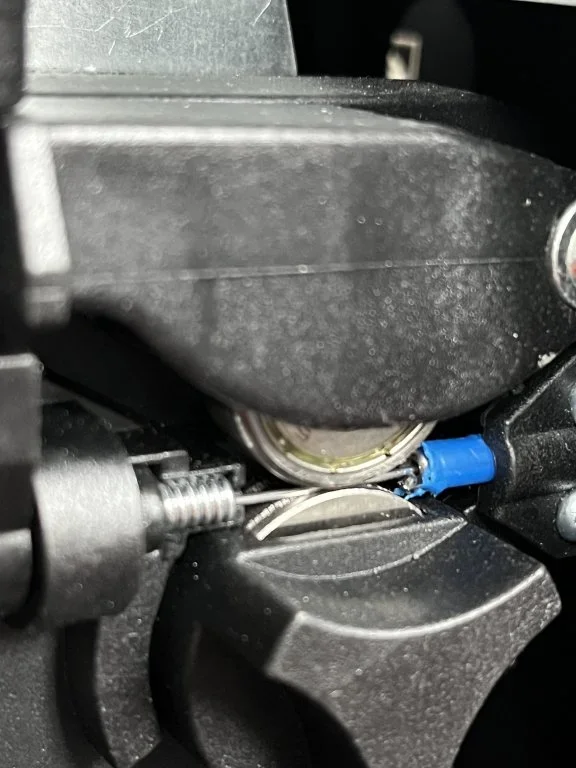

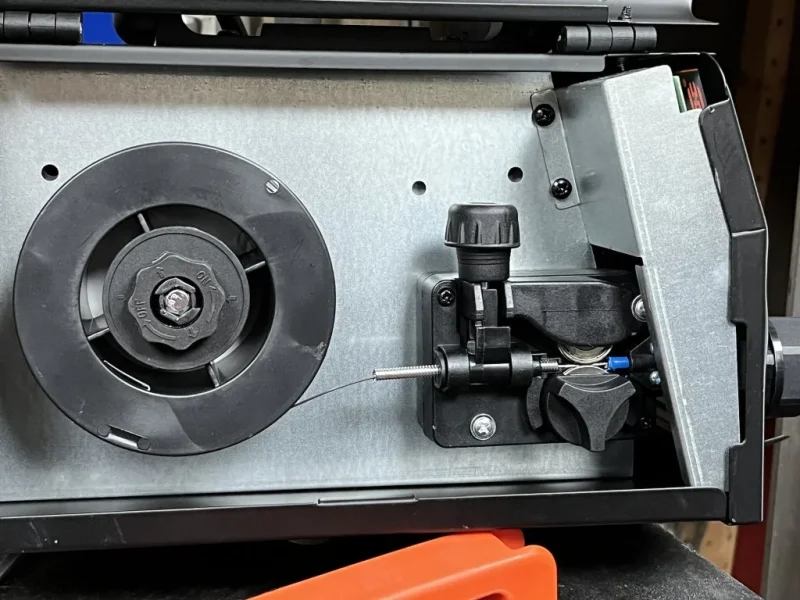

No readout, not even a wire speed control. The wire came well sealed, which is good, any corrosion on the wire causes chaos. Appears to have a steel liner which is also good, they last much longer than plastic liners.
0.8 or 1.0mm wheel fitted, I might try and get hold of a 0.6mm wheel and try the reel I just bought.

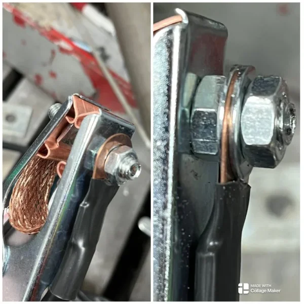

The earth cable wasn’t a great fit, 2 thin steel washers sorted that.
The torch is cheap, obviously, the switch is really light, I would prefer a stiffer spring. I don’t wear gauntlets, I either use tig gloves, or driver gloves, much better feel and they come in a range of sizes, gauntlets fit almost no one.

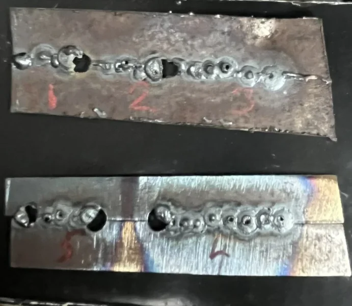

Well, first off it’s bright, tested on a piece of thick scrap I eventually settled on shade 11.5, on thin 1mm steel I went to 11.25.
I weld thin bodywork with no gap, use a technique variously called, tack and chill/zap and chill/stack-a-tack, all the same. A full penetration tack weld, immediately chilled with compressed air, or wet rag, worked across the clock. It produces minimal, if any, distortion.

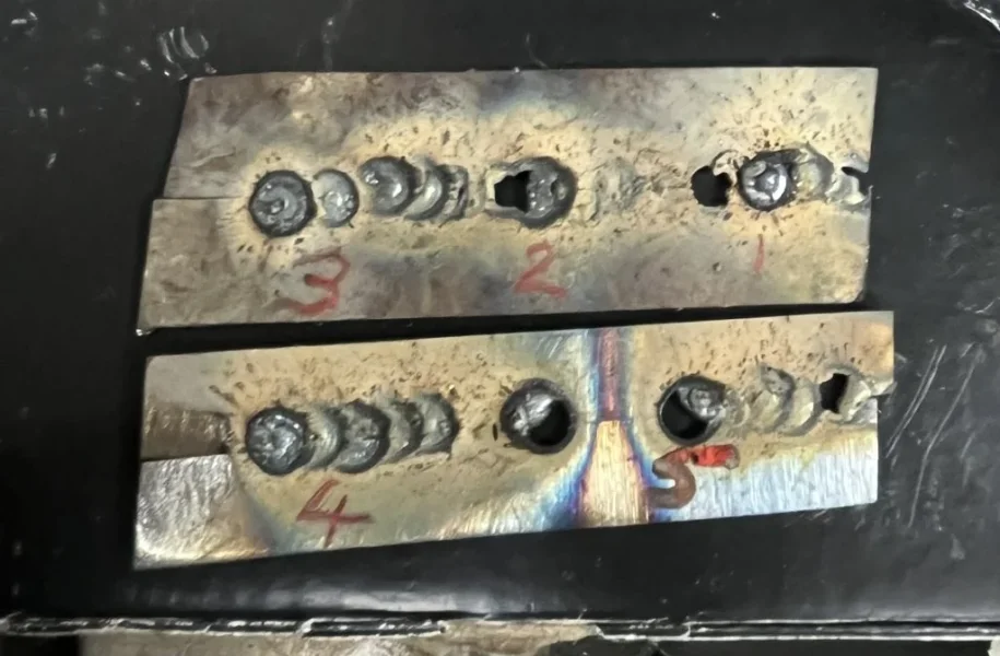

Minimum setting
1
Immediately obvious, Very hot. straight through.
2
Heats up really quickly, straight through.
Much shorter tacks than gas, maybe 0.5s on, then 3sec off and I can run a line of tacks.
4
Same, that works.
5
I think little test strips heat up too much , even 3sec off and I’m burning through.
Minimal build up on the front face, it wouldn’t take much to grind flush.
Reverse side
I’m getting full penetration, I think, even on the min setting, which allegedly is 30 amps. I’m getting significant pitting, or cratering, on the back side. I need to grind the back side to see, but that will need to wait until the weekend, too noisy tonight and I only had 20 mins to test it.
I’ll run some larger pieces this weekend in 1mm steel, same as the outer sill and some 2mm, the same as the inner sill.

Short answer to the Question: YES, you can.
Long Answer.
If you’ve never used a welder before I’d advise buying something a bit more ‘featured’. Wire speed control is a must for thin sheet.
Spend time making sure the earth connections are tight and you’re getting a Really good contact on the workpiece.

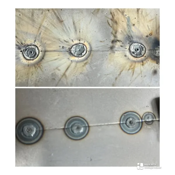

DO NOT use 0.6mm wire! You might think it’ll be easier to melt, but the arc is much fiercer, it burns through Very easily and gives a wider heat affected zone, haz. Turn it up just a fraction off min and it basically gives you a cheap plasma cutter, not a welder.
After burning through quite a few welding coupons I’d recommend 1.0mm wire, narrow haz, good penetration, consistent, less cratering and low build up.
CAVEATS:
Wear a good respirator/weld fume mask, this gives off LOTS of fume.
Spatter is impressive, keep flammables well clear, at least a meter.
Wear a cap.
Do Not try and run a bead on thin sheet, just doesn’t work.
You have to stop every 4-5 tacks and stretch them by hammering.
Tight fitment is a MUST, gaps will simply burn through.

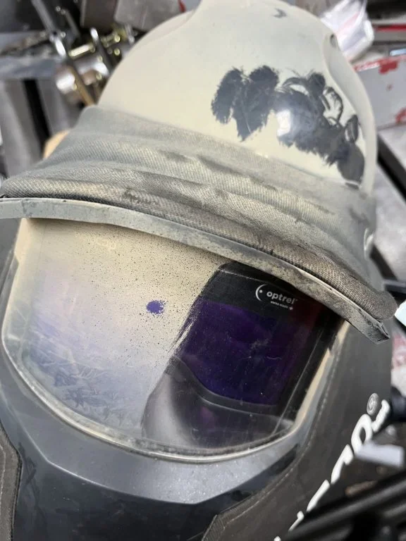

Check youhelmet visor is clean
This is how much fume it gives off

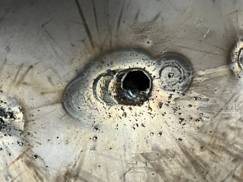

This is 0.6, wide haz, cratering, burn through and inconsistent.
This is 1.0mm, minimum build up, good penetration, narrow haz, negligible cratering.

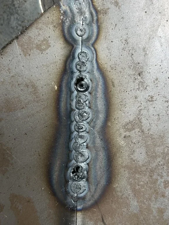

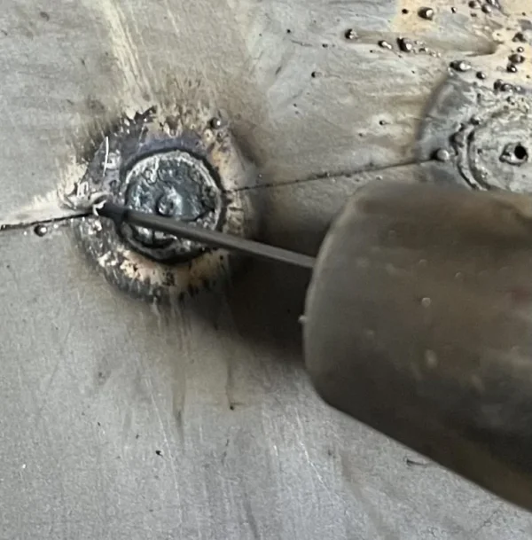

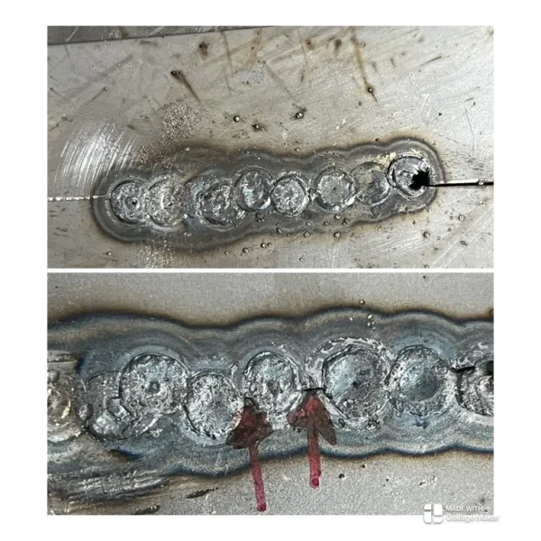

Here’s the problem I found. You want to overlap the tacks to form a seam weld, normally you overlap 50%, BUT, you MUST hit the metal of the tack. If you don’t the wire will hit the flux residue, which is an insulator, if it does arc it will have pushed the torch away, which then means you’re welding 15-20mm away from where you intended, like this.
All of that sandy coloured residue? It needs removed before EVERY tack. If you don’t you risk burning through, or cratering. You cannot stack more than two tacks in a row. Stop, clean, repeat, though really you want to cool it after two.
Three and a big hole.
Take you time, tack, clean, hammer, tack, clean, hammer, have everything in this picture.
Spot the spatter.
Half way along I didn’t overlap.
Tiny gap at the end and the weld pool slumpedthough that gap is less than 1mm.

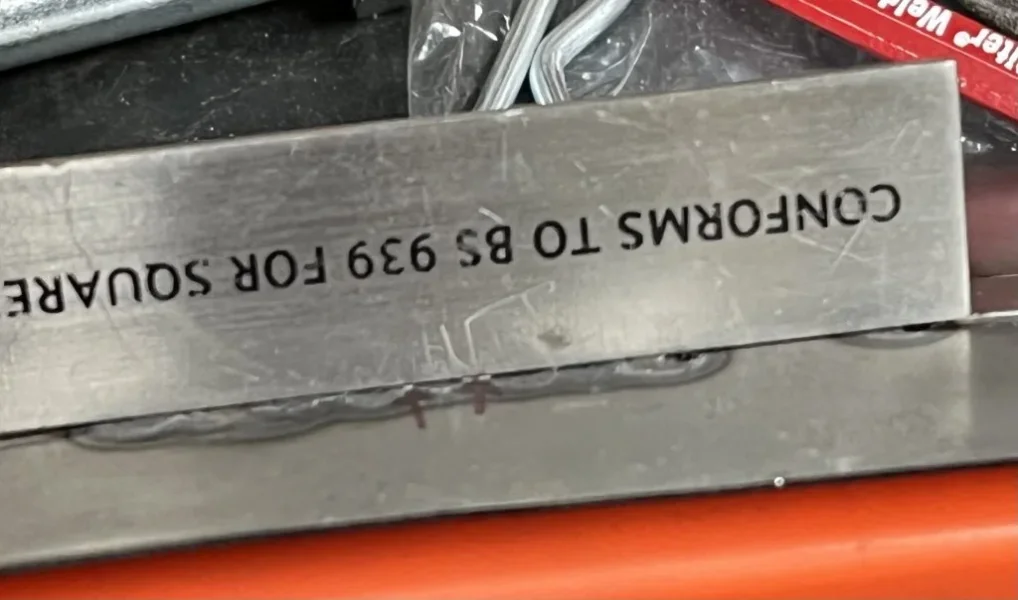

If the welds don’t overlap you don’t achieve full penetration, see the red arrows.
