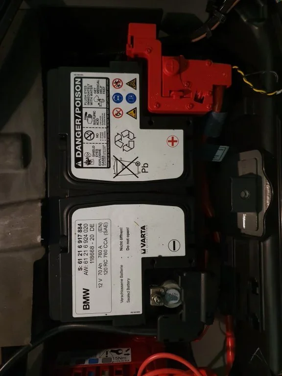

Ok, I give in, any idea if my battery is an agm or not? Tried googling the numbers on it to no avail .
Picture as below.
Thanks in advance.
agm ?

I'm trying to identify if the current battery is AGM or not.

No it's not an AGM
AGM and EFB batteries designed for stop start vehicles always say on them .
While we are on this subject if you do have an agm efb type battery in your vehicle it needs to be replaced by the same type .
A standard battery is designed to have about 20-30 k cycles an Agm battery is designed to have around 80 -120k cycles so if you replace an agm with a standard battery the start stop system will kill it in no time at all .
