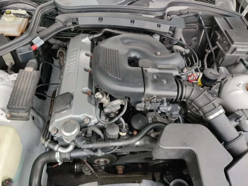

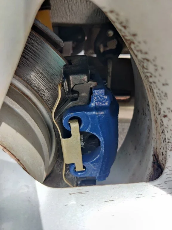

After nearly 2.5 years off the road fixing bodge after bodge it finally passed an MOT this afternoon.
She really should have gone to the crusher but I just couldn't scrap a Zed.
Only a couple of months ago I thought it was unsavable because the electrical bodges were getting too difficult and numerous to solve.
Just cosmetic stuff to do now.
She looks a bit rough on top still but underneath she's new.
New suspension
New bushes
All seals replaced
Rebuild gearbox
Rebuilt diff
New bearings throughout
Subframes blasted, treated and painted.
New bolts everywhere
New cills
All new sensors
New brakes with refurbished calipers
Rebuilt engine with new oil pump, chain, rings and journals.
Engine block soda blasted and painted with the alloy parts vapour blasted and lacquered.
Ported and rebuild head
Good used head lights
Excellent condition replacement seats
Replaced SRS/airbag system
Rust removed
Resprayed engine bay
Replacement binacle
And bodge removal.
Been driving all evening in it and loved it.

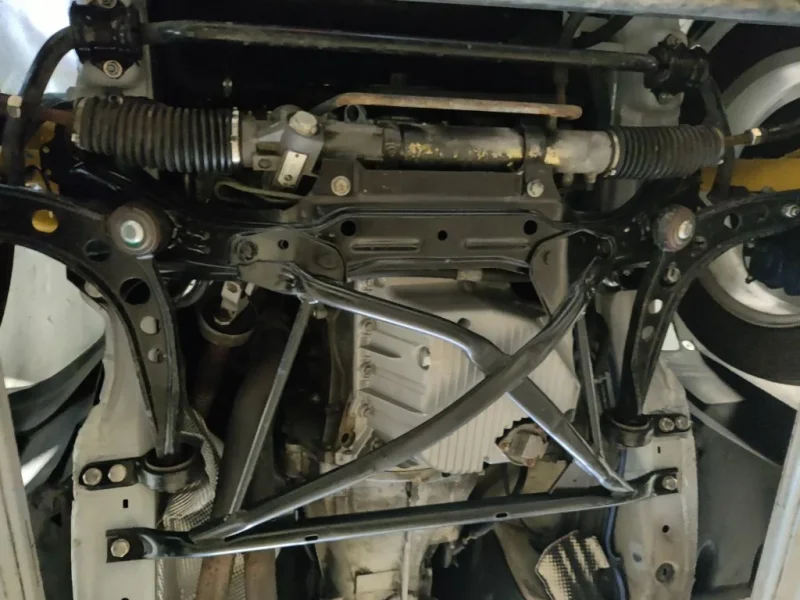

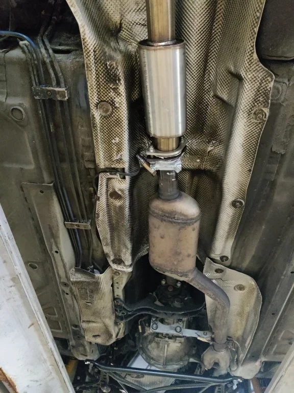

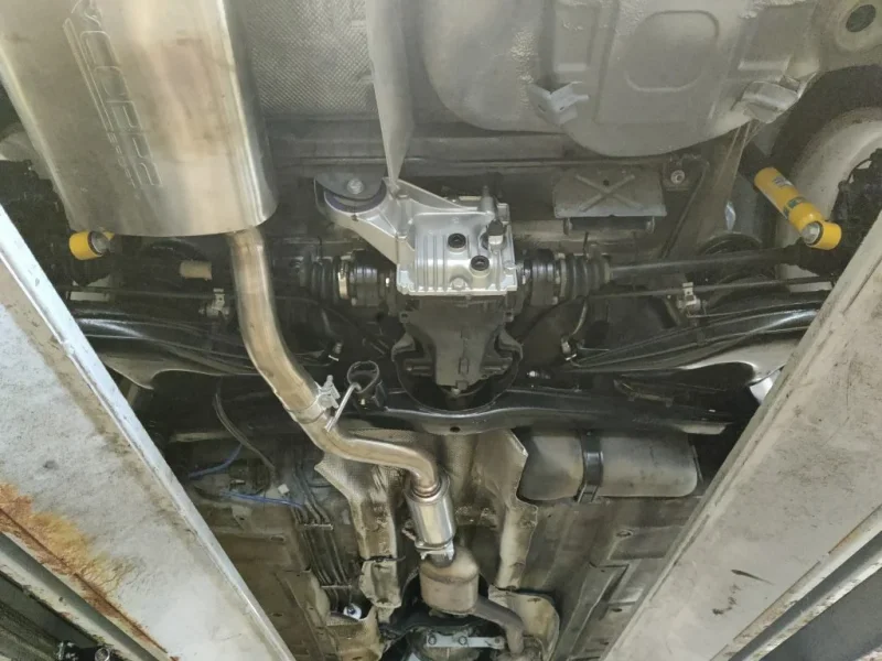

Managed to get a few quick snaps whilst it was on the ramps of the underneath.
I appreciate the exhaust is not the best fitted with clamps rather than weld. Only a temp fit whilst I got to see if it was for me. It's not and has to go. Sounds like a chav in his Corsa 🤣
Suits the car though.
