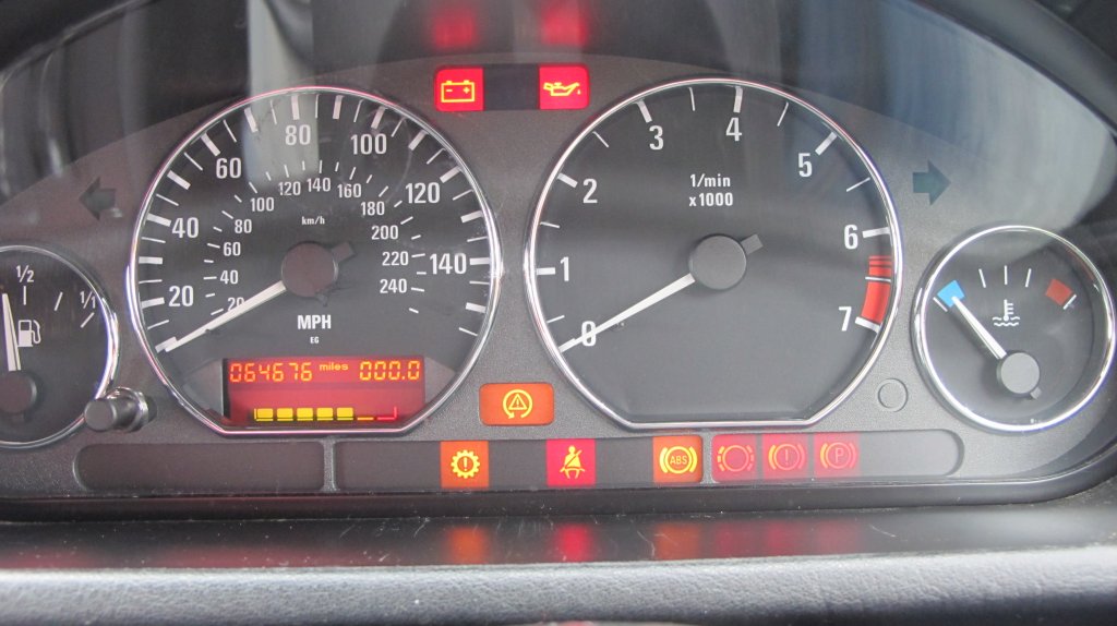

P.S. did you get your ABS/ASC lights sorted?
Cheers guys
@Brian H I haven't I'm afraid the guy who sold it to me is apparently on holiday and the other salesman won't deal with his customers.
OK, if you get nowhere with them let me know, I'm not a million miles away from you, have access to a code reader so can maybe sort something out.
