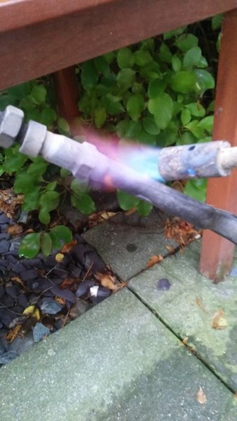

Get a small blow lamp. But be careful how you use it. 5 minutes then cold water has always loosened bolts/ nuts. Did this on my tie rods
