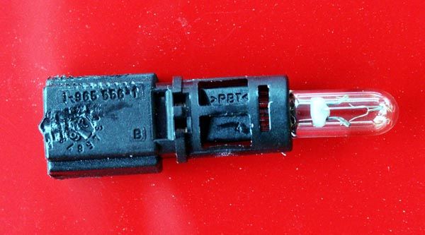

Bit late now you spent £11 but found these on ebay
Ah I bought the bulb and holder, when I searched online it read like everyone did the same change and not just the bulb.
I thought it was all one unit...this is what one is like insitu

I did note that the ebay ones list clear ones but they don't appear in the drop down choice, no doubt one of the other colours would do.
I seem to recollect fitting some replacement bulbs to someone elses car moons ago via the radio hole, bit of a fiddle but managed it.
