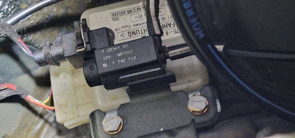

Hi people I’m searching for this in the boot of mz3 !
Is this it ???
tia
Is this it ???
tia

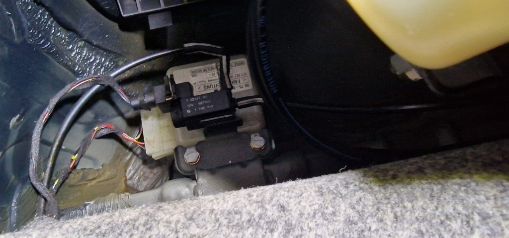

Thanks very much I’ll check under the carpet as you say ! I’ve disconnected the bonnet switch, but the lights still went off without any alarm sound so I’m working my way through things !Lower boot on left hand side ( below carpets) that is where mine is located on my 99 pre face-lift 2.8.
Plug looks different from your picture.
View attachment 287369View attachment 287371View attachment 287373
Alarm module is the lower one the black unit on top of it is the solenoid for the valved exhaust flap
